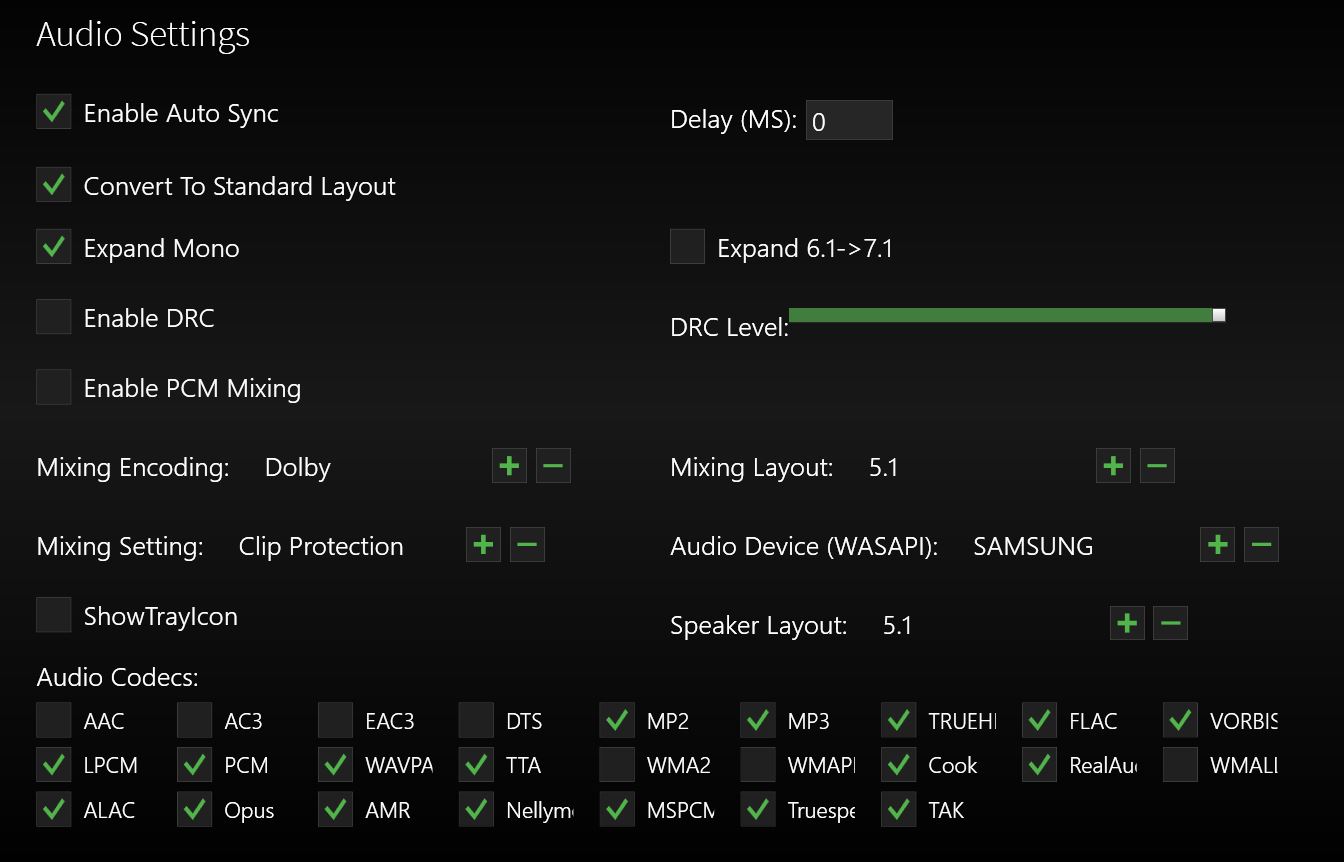

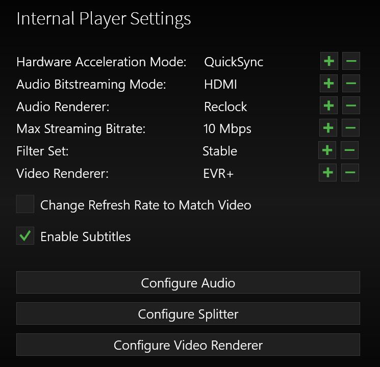

lulzyatlas 20 Posted December 6, 2015 Posted December 6, 2015 Simple question, but one worth asking, I notice you have a screenshot for your audio settings attached, but in the menu leading into that one, have you set HDMI as the Audio Bitstreaming Mode? To my knowledge this should tell Emby Theatre to pass all audio over the HDMI port and hand over audio processing to the device on the other side. Ignoring most of the options under configure audio as it and your internal sound card are no longer handling audio processing. If that doesn't work, confirm the HDMI is set as your default output for windows (it appears to be if the others do it fine), make sure Emby isn't transcoding (will downmix to stereo), or using a stereo audio track on the file (you can check this by bringing up the info window with the I key during playback). If those all check out I'd say you could try enabling PCM Mixing with Dolby as the encoding, but as a last resort as this would be reprocessing your audio.

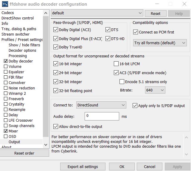

Guest asrequested Posted December 6, 2015 Posted December 6, 2015 (edited) I disabled native support for DTS and AC3, and use ffdshow. Then enable passthrough for those types. It works perfectly. You may need to use codec tweak tool, to disable the windows media foundation. Edited December 6, 2015 by Doofus

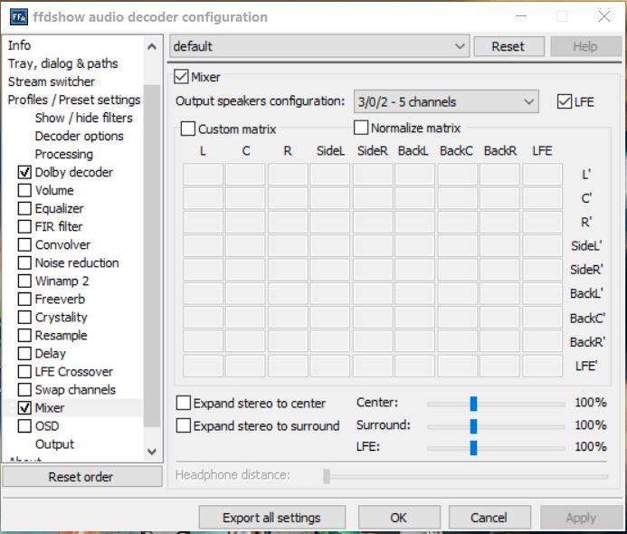

Guest asrequested Posted December 6, 2015 Posted December 6, 2015 (edited) First download and install ffdshow and codec tweak tool: http://ffdshow-tryout.sourceforge.net/download.php http://www.codecguide.com/download_other.htm Next, select HDMI in bitstreaming mode: Next, disable native audio decoding Next, open ffdshow and go to output. Select the settings you require. My receiver will play most things, so I selected them all. Also select AC3 encode and Connect to: Direct Sound. I also selected Mixer and Dolby settings. This is useful if you want to process 2 channel tracks, in this case I prefer ffdshow to handle AAC tracks. Ensure that the codecs are enabled, and you should be good to go. Enjoy Edited December 13, 2015 by Doofus 3
