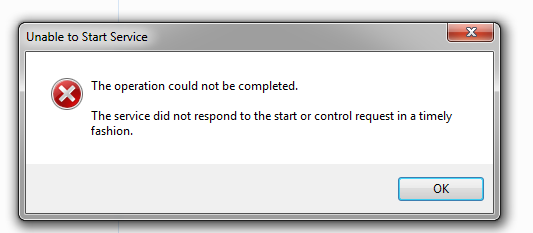

rsaxman 0 Posted January 12, 2016 Author Posted January 12, 2016 so i noticed that the Emby service was stopped. I got an error message when I tried to start it. i assume this is not right? pic of error message attached
