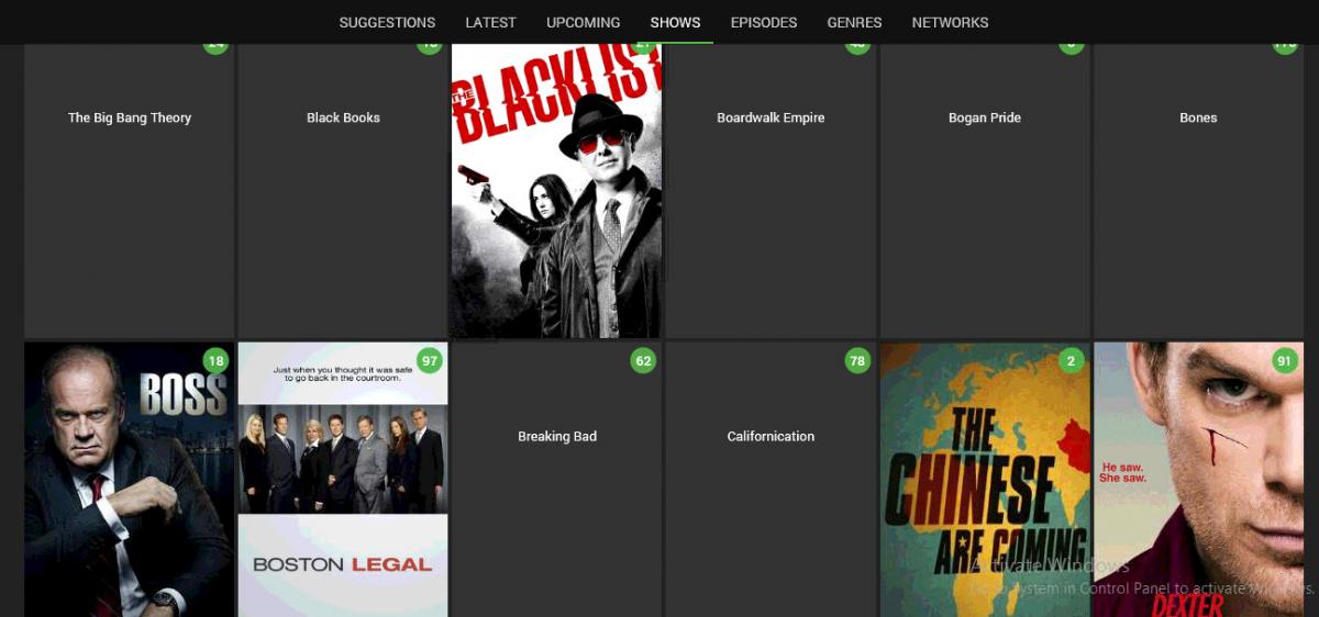

rjay 21 Posted December 3, 2015 Posted December 3, 2015 New user to Emby and stumbled across it recently looking for alternative to central MySQL dbase for Kodi. Have Emby Version 3.0.5781.4 setup on Windows Server 2012R2 and Kodi 15.2 with Emby Addon on two media machines. Seems to be working fine mostly, have just added my TV Series path from NAS as a start. What I can't work out is why it is it seems to have got down the artwork for some series but not others, after a lengthy initial library scan it seems there are a lot of artwork missing. Subsequent rescans don't fix the issue. Have searched the net and tried any of the things I could find that seemed related but have had no luck. Things I have tried/checked/know; Artwork is missing not just from the Kodi end but also on the Emby Server so its seems to not be downloading the artwork at all Series are all named the same and path and format is \\multimedia\video\seriesname\season x\S01E01 episode name.avi Series previously has artwork found when just added to Kodi locally The items missing the artwork seem to have other details like the synopsis just no artwork so it does seem to be find the series as such Tested and user logged into Emby server has write permissions to the Series folder structure What should I try next ? Attached is a screenshot from Emby showing what I mean regarding the art work.

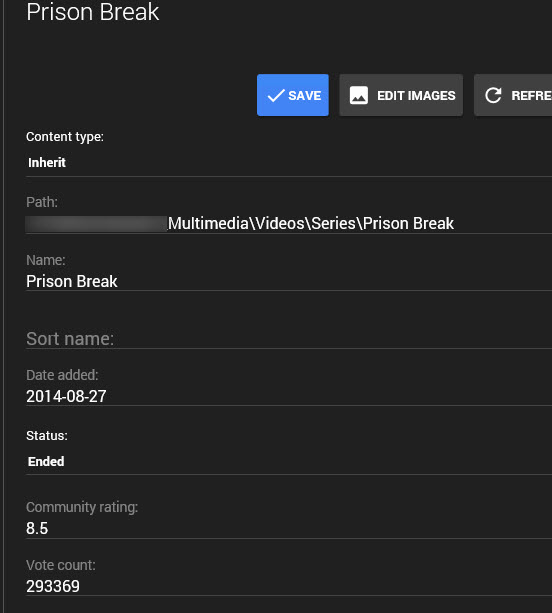

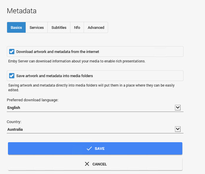

rjay 21 Posted December 7, 2015 Author Posted December 7, 2015 thanks for the reply ebr, don't think it is old data from Kodi. Attached is a screenshot of the data if I edit an item with working artwork, seems legit. Also a screenshot of the folder structure and showing the XML/photos present. The other folders that don't have images are just missing those files. Also attached is a photo of the settings and it does have the download metadata checkbox enabled. Any thing else I can check ?
