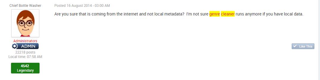

enthous 0 Posted December 2, 2015 Posted December 2, 2015 I just downloaded the GenreCleaner plugin, defined a bunch of stuff in settings, and then scanned my library. I expected the genre of my movies to change if I mapped an old genre to a new one. Nothing happened. I scoured the forums and saw a disturbing entry in one of them: a reply to a user that asked if he had defined any of his own genres. Am I to understand that this plugin doesn't do anything if I've defined even a single genre of my own? If this is the case, first, let's see that in the documentation (such as it is). Second, how to I get rid of my definitions and revert back to just the downloaded genres and get this to work right? I don't even know which ones are mine vs ones that got downloaded automatically.

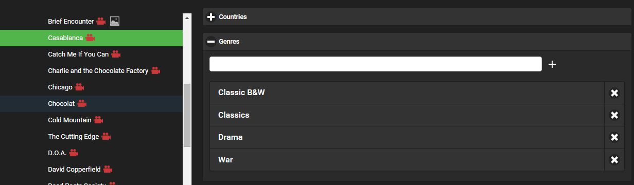

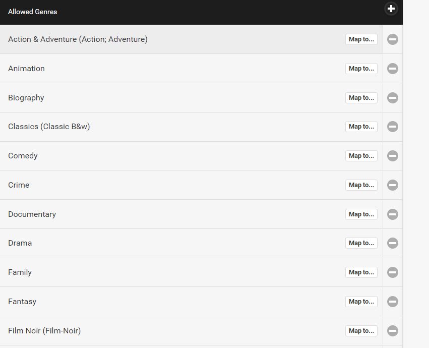

enthous 0 Posted December 3, 2015 Author Posted December 3, 2015 (edited) First, here's the post I was talking about. I must have misunderstood what "local" meant: About my problem: I used to have all my metadata locked, but I went through and changed a large number of them by unlocking Genres. Some of them are still locked and I'm not looking at any of those to see if this worked. There are so many it will be a while before I get Genres unlocked on all of them. Here's some of the things I mapped. After this I expected I wouldn't ever see Action or Adventure as a genre, just Action & Adventure. Similarly I don't want to see Film-Noir, just Film Noir, etc. As an example, here is my entry for Casablanca. I expected it would no longer show the genre Classic B&W any more, since that was mapped to Classics, and although you can't see it in the above screen snap, the genre War was mapped to Period & Historical. The Classic B&W and War genres are still showing in this film. Classics was manually selected; I don't think GenreCleaner did that. There's also no Period & Historical. As for the log, there's a ton of logs and I couldn't tell you which one was right after I did this. Would it help if I uninstalled and re-installed, then did the mapping and got the most recent log? Edited December 3, 2015 by enthous

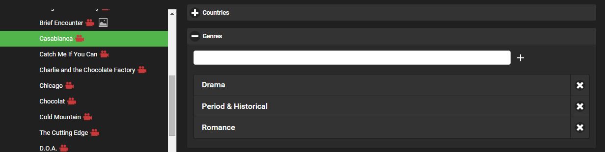

enthous 0 Posted December 3, 2015 Author Posted December 3, 2015 I just did a Refresh of Casablanca, and now War is gone and Period & Historical is there (yay), but Classics and Classic B&W are both gone: I've attached the most recent log. Log.txt
ebr 16342 Posted December 3, 2015 Posted December 3, 2015 I was just about to ask you to manually refresh the item. I'll look at the log to see if I can determine why those other genres aren't removed.

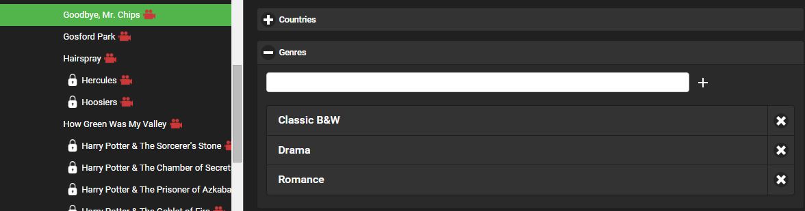

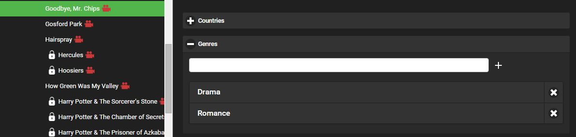

enthous 0 Posted December 6, 2015 Author Posted December 6, 2015 Since Casablanca no longer had the genres I moved to another one in the Classics B&W category: Goodbye Mr. Chips. Screen snap before the refresh: Screen snap after the refresh: Log after refresh with debug on.txt
Happy2Play 9814 Posted December 6, 2015 Posted December 6, 2015 Is the cleaner case sensitive? Look at your mapping "Classics (Classic B&w) and genre is Classic B&W. But I think the issue is a refresh. What kind of refresh are you doing? I believe you are doing a Refresh all which is replacing all you custom metadata since Classic and Classic B&W are not genres listed on the providers metadata. Confirmed this theory with a test by adding Funny as a genre and did a refresh and it was removed. Has nothing to do with Genre cleaner. The Genre cleaner task is run during library scan not a Refresh. 1
