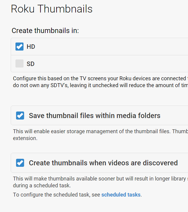

Luke 42185 Posted December 2, 2015 Posted December 2, 2015 Looks like everything is fine and you just need to configure the plugin.

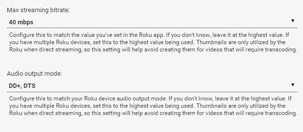

mediacowboy 438 Posted December 2, 2015 Posted December 2, 2015 @@kingstonian, I have so Rokue setting's for handbrake and a screen shot of the setting's for format factory if you want to use them to help convert and get more bif's. Let me know and I will post them.

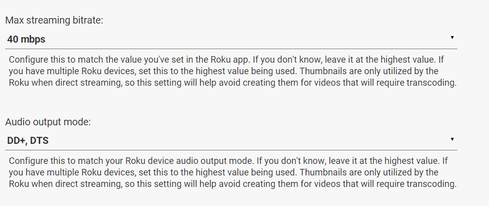

kingstonian 1 Posted December 2, 2015 Author Posted December 2, 2015 Thanks for replying Luke, just checked my settings and started another scan but nothing, The scan for the Bif took 0 seconds...
kingstonian 1 Posted December 2, 2015 Author Posted December 2, 2015 Correct. you only get bif files for content the roku will direct play, because roku will not use the bif when transcoding is used. What are your following setting's? Same as yours..
