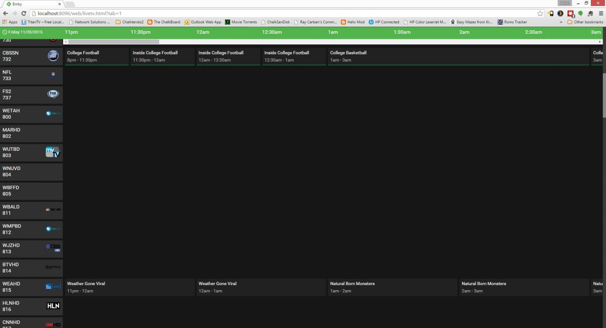

jasonchalk 0 Posted November 21, 2015 Posted November 21, 2015 Hello, I am desperately trying to get a working DVR software package for my Silicondust HDHR Prime... I am trying to get Emby working with SchedulesDirect and am having no luck whatsoever. See attached screenshot of missing schedule/grid data. Also, see attached log file from doing a SchedulesDirect pull. Hoping someone can see what is going on? I am getting maybe 20% of the guide and that is not enough... I bought a month-to-month on Emby and a 2-month subscription on SchedulesDirect -- hoping to have a solution so I can pony up for lifetime and annual subscription. I otherwise very much like the product! Thanks, --Jason server-63583658009.txt

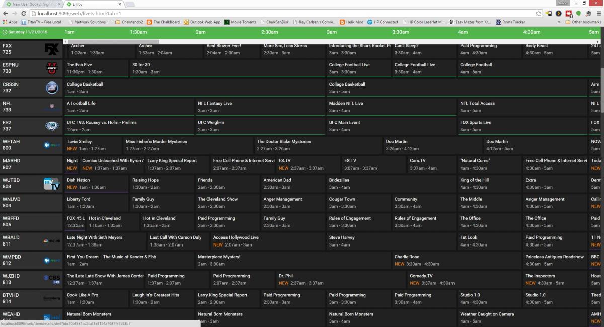

jasonchalk 0 Posted November 21, 2015 Author Posted November 21, 2015 Bam! The Dev version definitely did it! This is what I did: Enabled the debug logging... Installed the Dev server as you instructed Restarted Emby Then, for good measure, I deleted and re-added the tuner. Full Guide info. Woohoo!!! logs.zip
