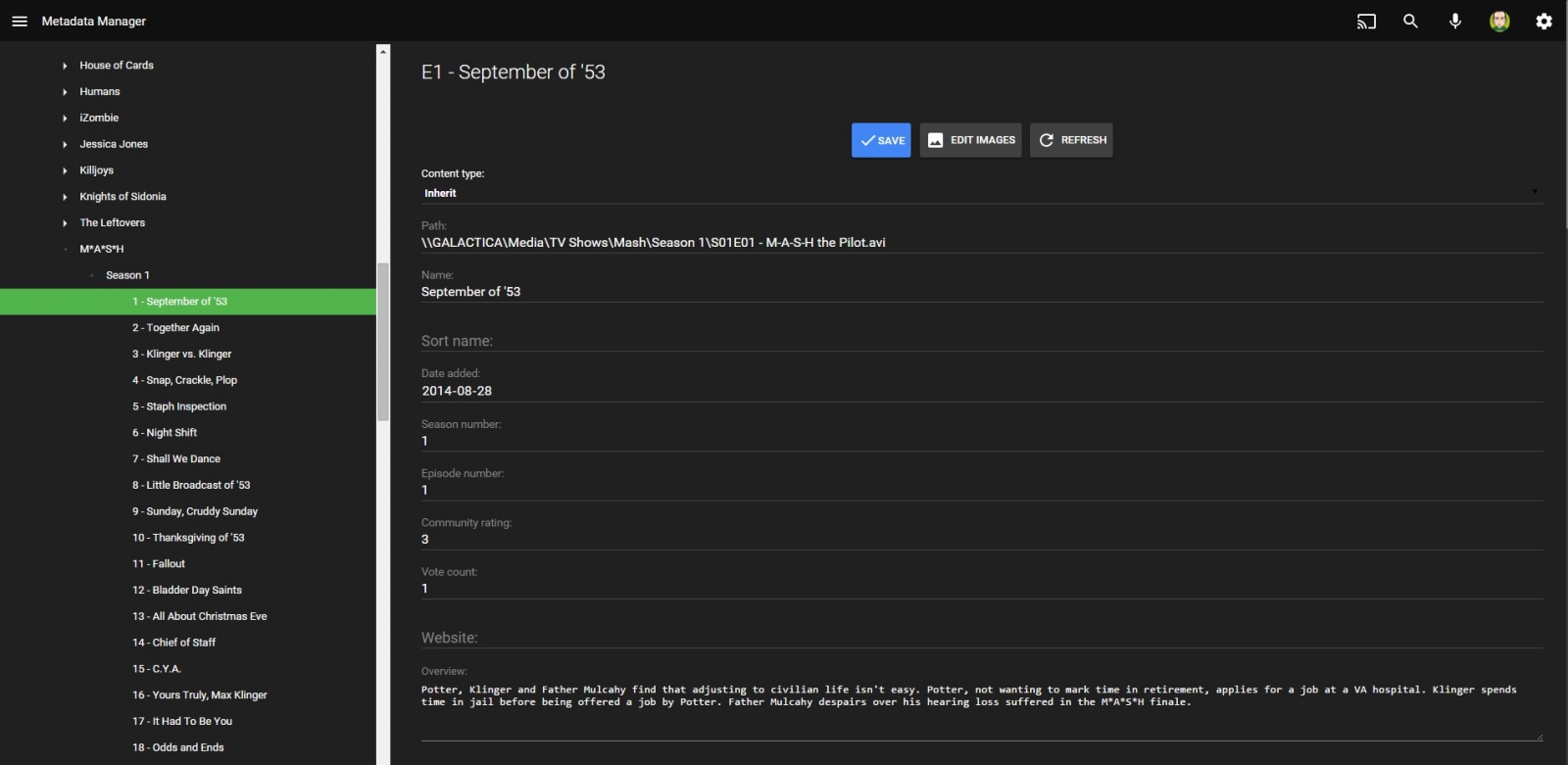

Redshirt 1487 Posted November 16, 2015 Posted November 16, 2015 I just did a completely fresh server install with no metadata from my previous install. Installed the current release version (3.0.5781.1) and during the initial scan server identified "M*A*S*H" as the spin-off "After M*A*S*H". Using the built-in metadata editor I identified the show correctly and refreshed. The show info has been corrected as has the season info, but the episode info is not changing to the correct show. I've tried deleting the episode info in the editor and saving with just the episode name and correct TVDBID for the episode. When I refresh, the info is just overwritten with the incorrect info. I've attached a server log showing what happens when I refresh an episode from the editor. Let me know if you need more. Thanks. server-63583228800.txt

Redshirt 1487 Posted November 17, 2015 Author Posted November 17, 2015 Manually refreshed from the both the metadata manager and the hamburger menu in the web client episode details page. Just in case the refresh was recursive I also tried refreshing from the series and season levels of the metadata manager. Do you have the show in your own collection? If you want I can probably whip up a 0-byte zip of the show.

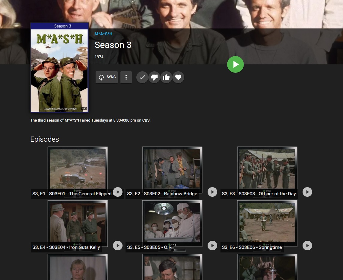

Redshirt 1487 Posted December 5, 2015 Author Posted December 5, 2015 I resolved this yesterday. I had to change the SSD on my server which meant another new emby install, ugh... I renamed the MASH directory to MASH (1972). When emby rebuilt the library it wasn't able to identify the series as anything. Manually identifying the series allowed the episodes to be correctly identified. So it seems the issue only occurs if the episodes get mis-identified in the first place. Unidentified things change no problem.
