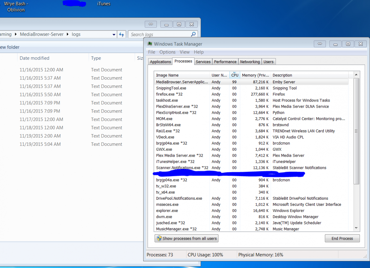

thefranklin 0 Posted November 19, 2015 Author Posted November 19, 2015 (edited) I manually woke my pc this morning and got the same issue of 100% cpu usage and non-responding server. I took the screenshot at 5:40, so it had been in this state for 35 minutes. I don't think it is going to recover I restarted the server and all is well again, no cpu usage at all. It is using close to 138k of memory. is it possible that Emby server is trying to access the interwebs before my pc has woken up my internet connection? I see a huge lag time in there at 504. Thanks, server-63583508668 - log -restart.txt server-63583495202 - log-crash.txt Edited November 19, 2015 by thefranklin
