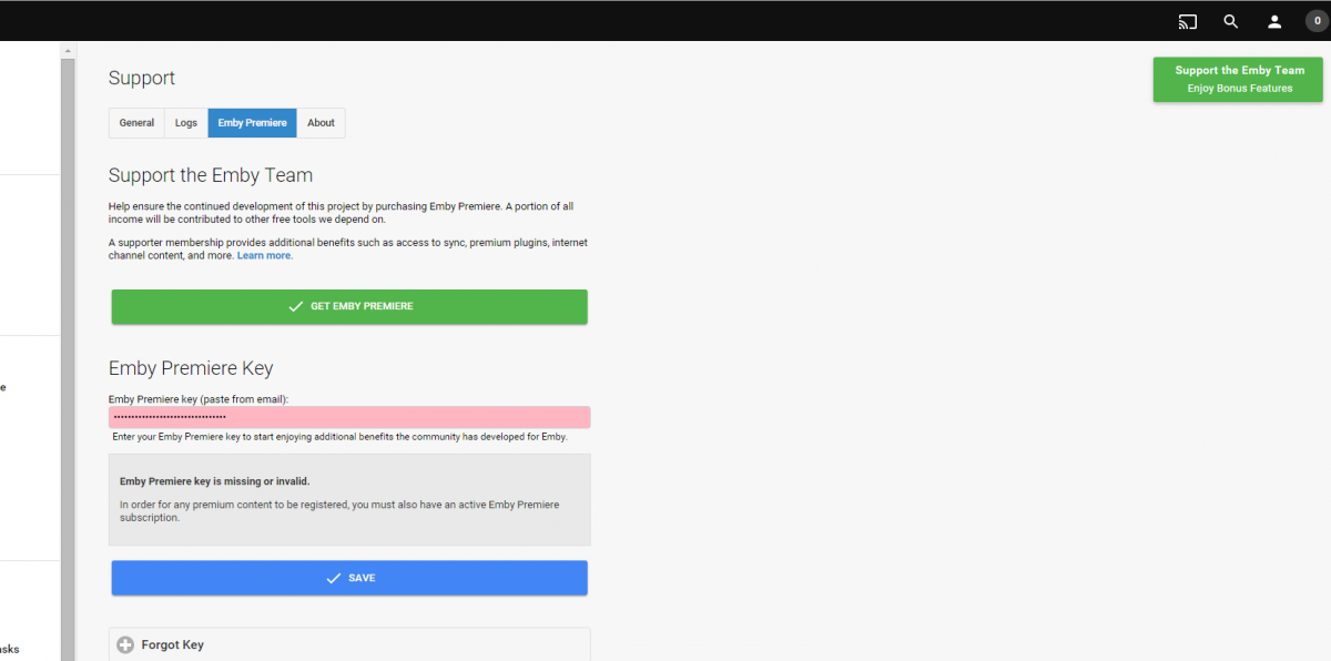

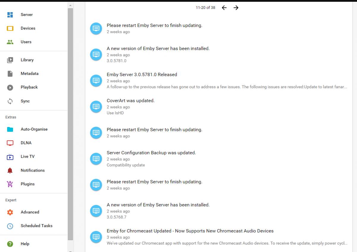

Steverido 6 Posted November 13, 2015 Author Posted November 13, 2015 Right Guys, See attached screenshots to assist with the supporter key issue. I have tried to input my old supporter key a few times and it will not accept. See screenshot. This has happened since the last update a few days ago. I have noticed that since the update 3.0.5781. the backup configuration has not been completing either. Not sure if this is a related issue. I also noticed that the TV stuff has lost the played status and that all the folders were showing the exact amount of shows in each folder on the covers. Not sure why this has happened either. Hope this helps. server-63582840157.txt server-63582763604.txt server-63582694527.txt Migration-30102015b0a506eab7c64fecba1c078337978110.log MBClassic-Msi.log MBClassic-231020152072643f5bc04e93b1103cd676159f6a.log MBClassic-12112015616d5a1f53e94ebc913a1013fe3ac9dd.log
Luke 42242 Posted November 13, 2015 Posted November 13, 2015 Ok, I can see a failure to parse a response from our admin server. We're looking into this. Thanks for putting together this info.
Steverido 6 Posted November 13, 2015 Author Posted November 13, 2015 Ok, I can see a failure to parse a response from our admin server. We're looking into this. Thanks for putting together this info. Thanks Luke.

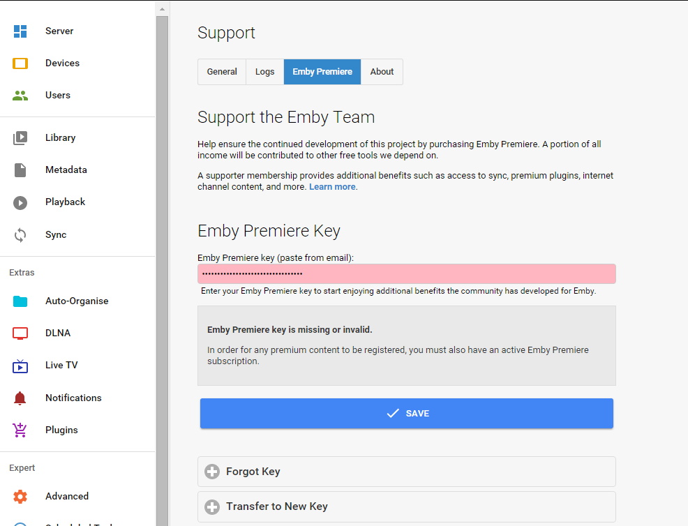

Steverido 6 Posted November 16, 2015 Author Posted November 16, 2015 I couldn't find any validation errors in either of those logs... My key is not accepted though ebr. Should I uninstall and download again or do you think that this will not work?
ebr 16335 Posted November 16, 2015 Posted November 16, 2015 You say "not accepted" but the screen shot you showed above looked fine. Do CoverArt treated images show up properly?
Steverido 6 Posted November 17, 2015 Author Posted November 17, 2015 You say "not accepted" but the screen shot you showed above looked fine. Do CoverArt treated images show up properly? ebr, the software will not accept my supporter key. I have attached screenshots taken today. The CoverArt does not show and neither does the Backup Configurator because the key is not acceptable. I have a PC upstairs which is used to store TV series that I am gathering each week and this Emby server is the latest too and the key works fine. Surely it must mean that the installation got corrupted! I don't want to have to reinstall and reconfigure it again if it is not necessary.
