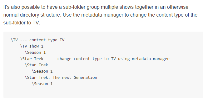

zsolmanz 1 Posted November 11, 2015 Author Posted November 11, 2015 (edited) You can't use that kind of sub-folder structure within a true "TV" library. Really? Then what does this all mean? (From https://github.com/MediaBrowser/Wiki/wiki/TV%20naming) Edited November 11, 2015 by zsolmanz

ebr 16307 Posted November 11, 2015 Posted November 11, 2015 Sorry, I forgot about the direct content-type manipulation. Did you do that? Did you change the content type of the top "Star Trek" folder to TV?
zsolmanz 1 Posted November 11, 2015 Author Posted November 11, 2015 (edited) ...I can enjoy all my generations from my collection.Do you access your collections from within your TV library? For me, Collections appear under Movies. (Not that that's a deal-breaker, it's just mildly irritating) <snip> Did you change the content type of the top "Star Trek" folder to TV? Yeah, but only 3 minutes ago - I hadn't quite worked out what it meant at first. No change yet, in spite of refreshing it - is there any way I can force it to update? Edited November 11, 2015 by zsolmanz
