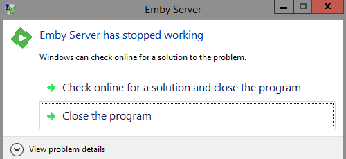

Cirdecus 3 Posted November 7, 2015 Posted November 7, 2015 (edited) I have an Emby server that was running on Server 2008 R2 and I have 2 media center PC's and an xbox extender. Out of the blue, Emby Server would crash when one of the WMC clients launched the Emby Classic program. I reinstalled the server software, reinstalled all classic software on the media centers and the problem persisted. So I then completely reformatted the server, installed Server 2012 R2 and then installed Emby and configured it from scratch. Sure enough, it continues to crash when a WMC client connects Help! UPDATE: It appears to crash regardless of whether a client attempts to connect. When watching the scheduled tasks, I notice that Emby crashes as soon as the "Clean Database" task initiates. Before removing all library items and adding only the: Movies, TV Series, Games and Books, Emby would crash when a "Scan Media Library" scheduled task was initiated. Now the library scan completes without a crash but the clean database task will not. server-63582491528.txt Edited November 9, 2015 by Cirdecus

Cirdecus 3 Posted November 12, 2015 Author Posted November 12, 2015 Thanks ebr. Basically as soon as a MB Classic client connects (opens emby from within WMC), the server software crashes. After a reformat of the server and a reinstall of all client software Emby would simply crash on its own after so many minutes (10-15 minutes). After continued troubleshooting, I decided to watch the scheduled tasks and noticed that as soon as Emby started "Clean Database" it would crash. I have since completely stopped the "Clean Database" scheduled task and Emby has been ok. I started the clean database task just now and watched it crash. I attached the log above, hope this helps. Thanks!

Cirdecus 3 Posted November 12, 2015 Author Posted November 12, 2015 I get a windows error and then the program shuts down. I posted a screenshot above of the error.

ebr 16307 Posted November 12, 2015 Posted November 12, 2015 It looks like a failure at a very low level because the server traps normal exceptions and would give you a different kind of message and write out an "unhandled" log of the exception. Is it possible that you have a hardware driver issue or actual issue with either a network or hard drive? If you can add in your library in small pieces and narrow down when it fails that might give some clues.
