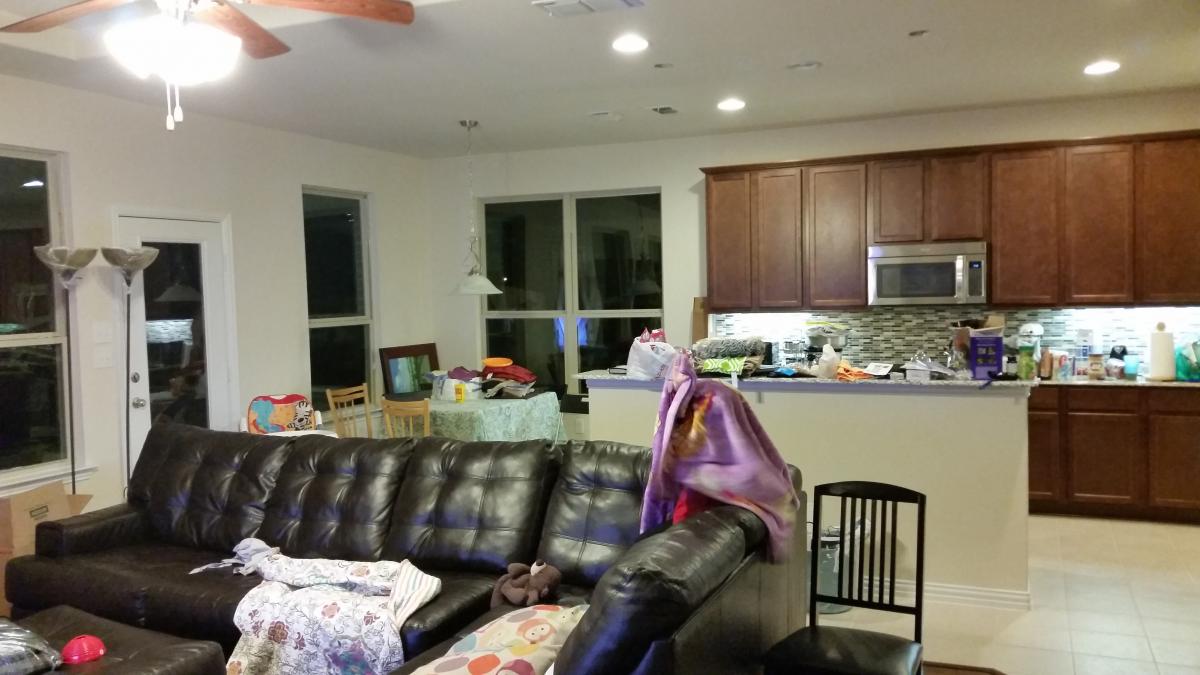

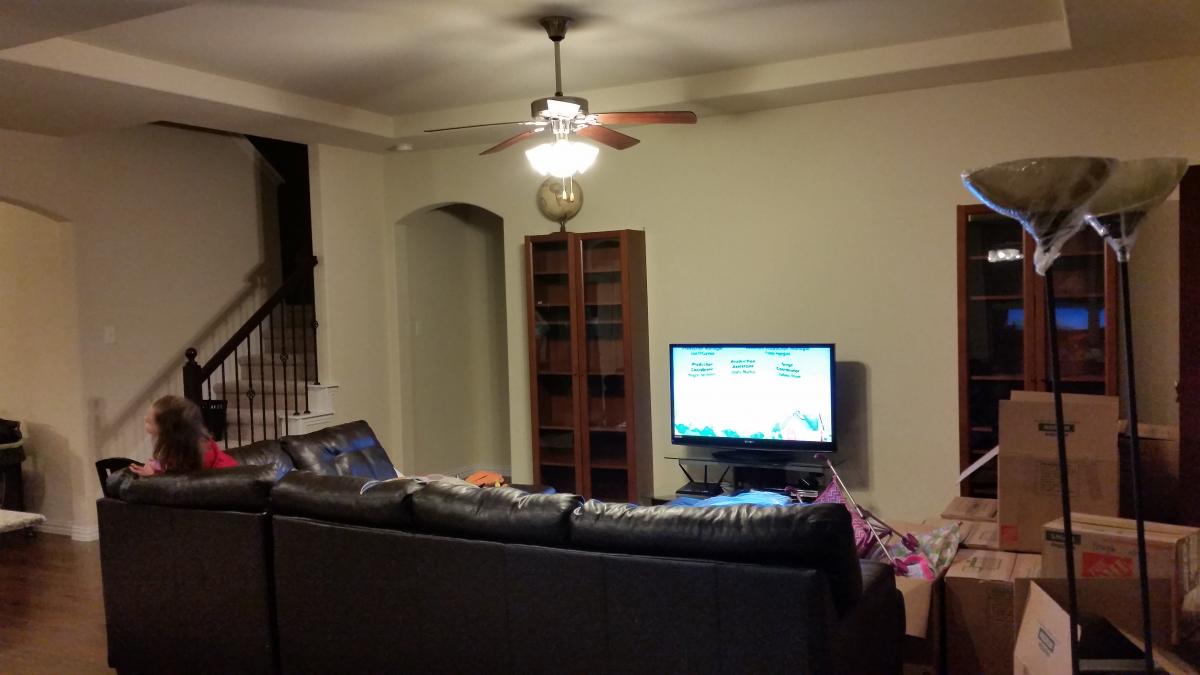

virtualtinker 8 Posted November 7, 2015 Author Posted November 7, 2015 I attached pictures of the room I am looking at to give you an idea of the size and layout; ignore the Doc McStuffins and crazy child. I would honestly prefer to just go the soundbar route, knowing that there will be drawbacks going this route.
Deathsquirrel 745 Posted November 7, 2015 Posted November 7, 2015 Am I right that there's abot 8 feet of wall between the bookcases and that the couch is 8-10 feet back from the tv? If so I'd recommend a TV around 60-70 inches, likely 1080p. If you're interested in UHD check out the same content in UHD/HD on a screen that size from a comparable viewing distance to see how much difference you can see, if any. For a screen that size at that distance the answer is likely no visible difference at all. I'm not a soundbar user but in the first three soundbar review roundups I glanced at the yamaha yas-203 got top marks so that would be my starting point for research. I'd check out crutchfield as well for comments and reviews.
