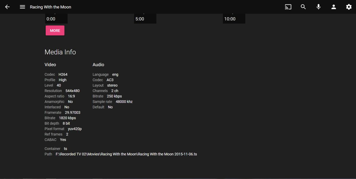

I have noticed that on the Movie detail screens for movies that appear both in Guide and Recordings, more times than not, the movie year not displayed.  Furthermore, with respect to Recordings, the movie filenames include the date of the recording rather than the movie year -- which makes metadata searching very difficult.

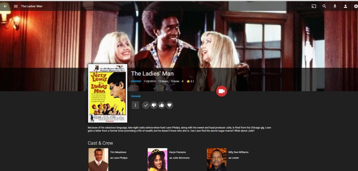

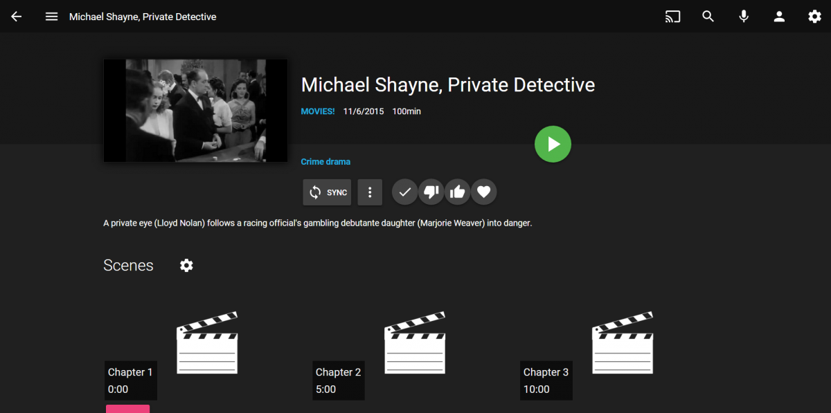

I think I should have mentioned that I am referring to Movies I have recorded using Emby in Recorded TV.
I checked the metadata manager and not one OTA  movie I have recorded using Emby so far has the movie year in metadata.  See attached.
It does, however, appear that most of the OTA TV shows I have recorded DO contain the release date and year in metadata.
SomebodySysop
Not having the movie year causes this problem (see attachment) where you have a poster and description from two different movies in different years with the same name.  Very frustrating.  Is there anything that can be done about this?

This I understand.  However, what is unknown is if Emby is even configured to get the movie year from OTA guide.  For example, a description of the movie appears in the guide popup (when you roll your cursor over an item in the guide).  However, this description disappears in the movie detail screen (or in the metadata) after the movie is recorded in Emby.  See attachments.  Is this by design or an accidental omission?
I am using Schedules Direct and have asked them the same question.  However, I know for a fact that there is some metadata that is in the guide that is missing from the recorded movie.
