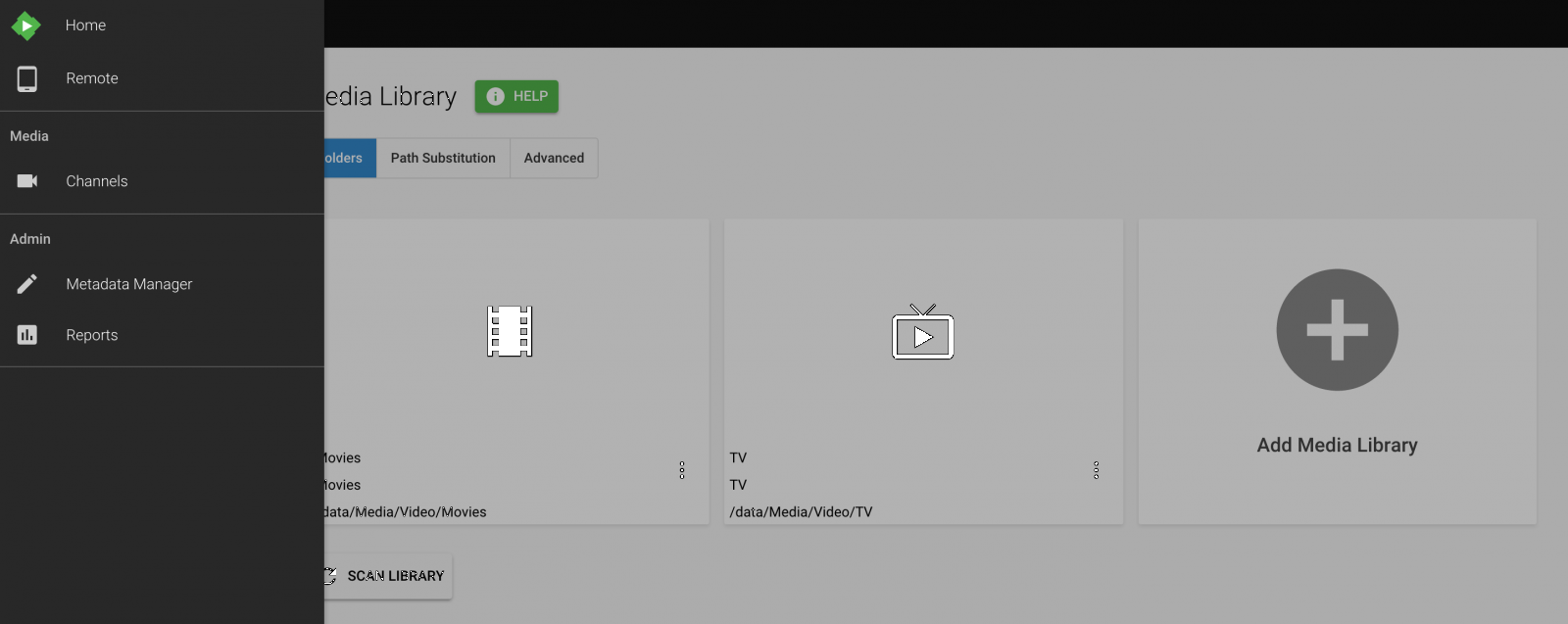

ksten 0 Posted October 29, 2015 Posted October 29, 2015 Version 3.0.5768.7 Emby Server is up to date Running on http port 8096, and https port 8920. After installing the tunein channel plugin, all of my other media no longer shows up in any client (only the channel does).
Luke 42243 Posted October 29, 2015 Posted October 29, 2015 Thanks. I'll review the plugin for any possible incompatibility. I would just remove it for now. I'll update when I've taken a look at it. @@Happy2Play do you have a moment to try this? thanks.

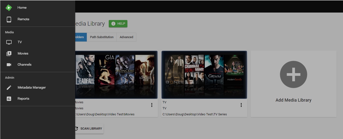

Happy2Play 9812 Posted October 29, 2015 Posted October 29, 2015 Can you post a server log. All I have is windows systems but I am unable to reproduce. Added Tunein same results. Remove all plugins except Tunein same results. 1
