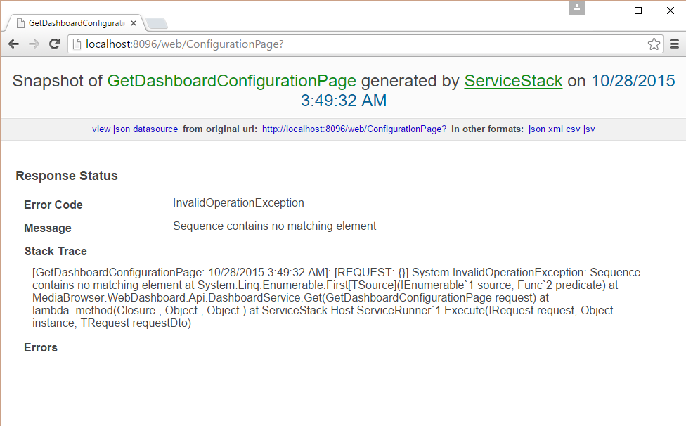

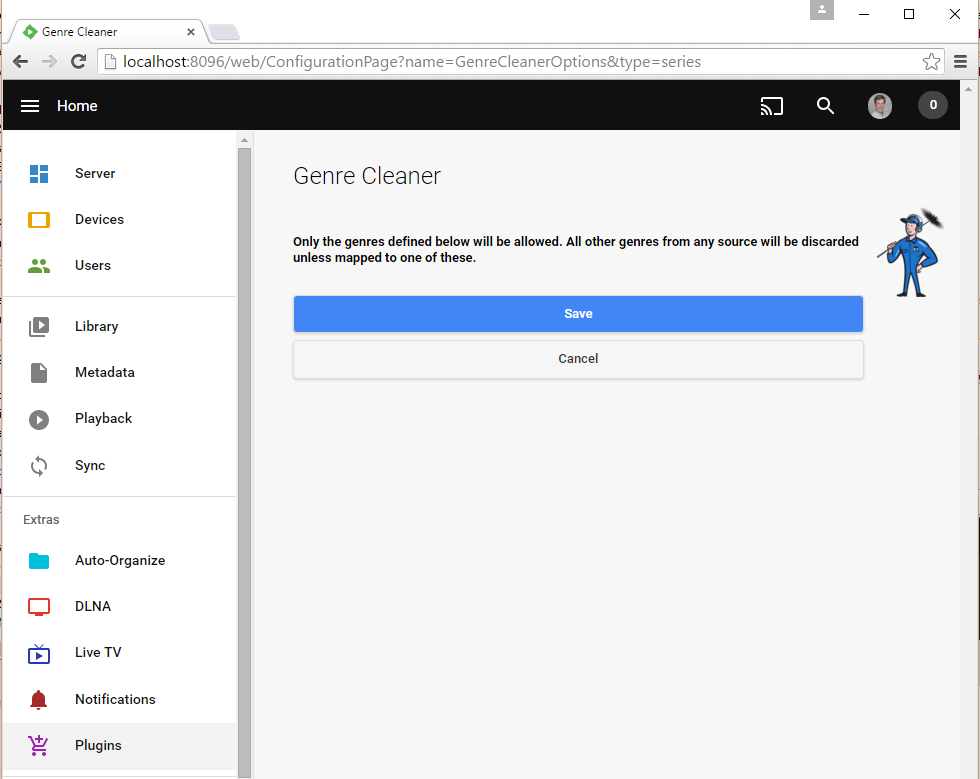

Chuck 17 Posted October 28, 2015 Posted October 28, 2015 Emby Server Version 3.0.5768.7 If I see this image in Genre Cleaner and hit the Save button I get this error If I then hit the back button, I will see either the link to load existing genres, or this list of genres if it's already been loaded.

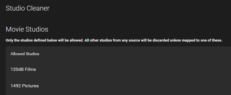

Happy2Play 9814 Posted October 28, 2015 Posted October 28, 2015 (edited) I get the same error in studio cleaner when hitting save to early, the issue if you hit save before the menu/list populates you get that error. In Chrome if I hit F5 to refresh the page it would populate the menu if it failed during opening. I would assume the same would apply to the Genre Cleaner also. No list After F5 refresh Edited October 28, 2015 by Happy2Play Studio Cleaner 3.0.5631.17552
ebr 16342 Posted October 28, 2015 Posted October 28, 2015 This is the exact same problem as with CoverArt that Abo has been reporting daily . If you go to a plug-in page with one set of url parameters and then back up and try to go to that same page with a different set of parameters, the url parameters are not recognized and the page does not load properly. Refreshing the page fixes the problem. This used to work fine but, somewhere along the line (I think when caching got a bit more aggressive) it broke.
Luke 42252 Posted October 28, 2015 Posted October 28, 2015 I've resolved this for the next release, thanks. in the meantime as Ebr says, just affect the page. only a few plugins will be affected by this.
