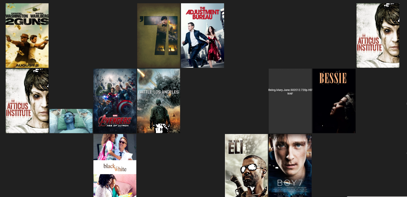

preed88 0 Posted October 27, 2015 Posted October 27, 2015 As I continue along my rebuild project, I continue to run into issues. I currently have three libraries added to my server: TV, Movies, and Music. TV and Music load cover art fine, but Movies is having a bunch of trouble. There are many missing icons all over the place for movies. Please see below: 3 When you hover over the movie you get this This is how my list looks: To attempt to remedy the issue, I figured a delete of the database would probably help, so I uninstalled and re-installed Emby server. No effect It seems its running into an error when attempting to serve the files, as evidenced by the snippet of the error log: 2015-10-27 17:52:18.0556 Error - HttpServer: Error processing request for /mediabrowser/Items/a6092f317dfb1f22fe2c1619e9e1177e/Images/Backdrop?maxWidth=500&tag=1a6b8194804392bfd60e1044a471abd5&enableImageEnhancers=true&quality=80*** Error Report ***Version: 3.0.5768.7Command line: /usr/lib/emby-server/MediaBrowser.Server.Mono.exe -programdata /var/lib/emby-server -restartpath /usr/lib/emby-server/restart.shOperating system: Unix 3.13.0.66Processor count: 664-Bit OS: True64-Bit Process: TrueProgram data path: /var/lib/emby-serverMono: 4.0.3 (Stable 4.0.3.20/d6946b4 Thu Aug 13 12:46:26 UTC 2015)Application Path: /usr/lib/emby-server/MediaBrowser.Server.Mono.exeFailed to read past end of stream.ServiceStack.HttpErrorNo Stack Trace Available

Luke 42243 Posted November 2, 2015 Posted November 2, 2015 either something is wrong with some of your images or something is wrong with image magick. i do see this Empty input file `/media/movies/Jurassic.World.2015.BluRay.1080p.x264.DTS-HD.MA-HDC-poster.jpg' @ error/jpeg.c/JPEGErrorHandler/322 ImageMagickSharp.WandException
preed88 0 Posted November 2, 2015 Author Posted November 2, 2015 either something is wrong with some of your images or something is wrong with image magick. i do see this Empty input file `/media/movies/Jurassic.World.2015.BluRay.1080p.x264.DTS-HD.MA-HDC-poster.jpg' @ error/jpeg.c/JPEGErrorHandler/322 ImageMagickSharp.WandException That's what it was. Corrupted image files in the NAS that a previous installation attempted to save to the NAS. As to why it saved as 0kb, I am unsure. I have removed the 0 kb entries, but now I either have text art or random thumbnails. I would like Emby to rescan and re-do the images, and I have removed the library and re-added it under a differing name with no effect. Is there a way to manually make Emby rescan the database for images? Thanks for the help, I became a supporter because of it.
