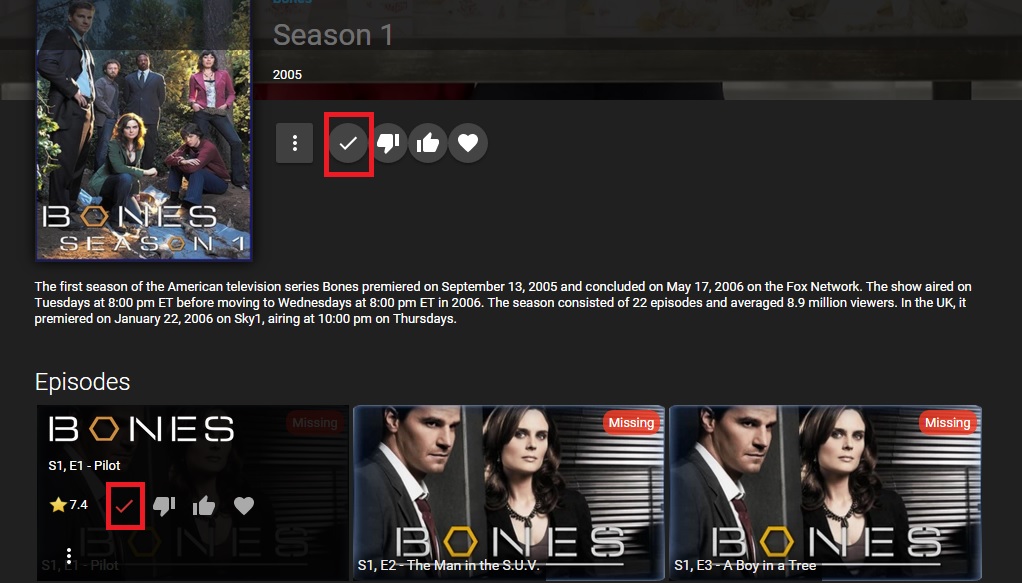

Happy2Play 9800 Posted October 25, 2015 Posted October 25, 2015 Still can't replicate, enabled missing and unaired, marked season as watched and refreshed page and all current episodes were marked as watched. But I use xmls so I don't know if that makes a difference. Or are you referring to Seasons in which you have no episodes and marking as watched as displayed here?
aj_hix36 2 Posted October 25, 2015 Author Posted October 25, 2015 I have the episodes, and I mark them as displayed like you did in that picture, or even from the view above it where it shows only seasons, and then check mark it, but it does not change the episodes at all, and if I refresh the page the checkmark on the season goes away too.
