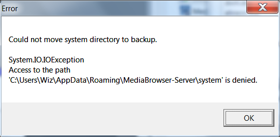

wizbowes 4 Posted October 24, 2015 Posted October 24, 2015 Hi, I've been suffering from constant (two or three times a day) crashes of the server which requires a restart. Additionally not sure it's related every update fails to install - on every reboot it asks me to update, claims it just needs to restart, then boots again. Generally I need to boot into safe mode, remove current version and then reinstall I attach a copy of the server log for the latest crash, and a log file before an update, and after that update - showing the unchanged version number. after-restart.txt Crashlog.txt restart.txt

wizbowes 4 Posted October 25, 2015 Author Posted October 25, 2015 Just tried it again - made sure there was no ffmpeg process running and restarted the server - same result. Donwloaded the latest build from the website, tried to update and got the following error Tried the link you gave - but same result as before. Looks like it works - but when I log in it it's the old version and says it needs to restart. Hit the restart button and nothing happens. Give up waiting, restart the server service manually and when I get back in it's the old version and says it needs to restart to complete the update.
Solution Happy2Play 9800 Posted October 25, 2015 Solution Posted October 25, 2015 So you have the same issue I have you have to wait for the server process (MediaBrowser.ServerApplication.exe) to die before you can perform any updates. The devs have not been able to find a cause for this but you are not alone with this issue. http://emby.media/community/index.php?/topic/6865-server-process-is-not-closing-on-restart-or-restart-is-attempted-to-soon http://emby.media/community/index.php?/topic/20290-update-fails/ 1
revengineer 142 Posted October 25, 2015 Posted October 25, 2015 On my server, it can take up to 5 minutes for the process to disappear from the task manager.
