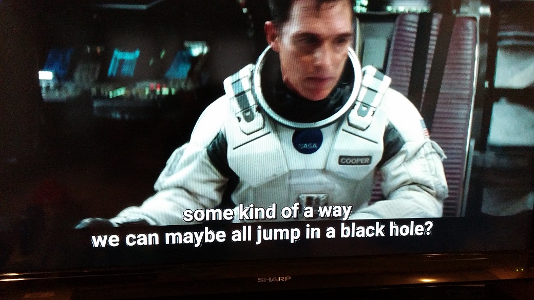

dingtech 1 Posted October 26, 2015 Author Posted October 26, 2015 (edited) Thank you very much! I tried the new beta version (1.1.17) and embedded UTF-8 text subtitle worked great now. One minor thing: there is ghosting on all the texts. See attached picture. Another stability issue: I used Home key to exit while the Emby was playing a video and after a while when I tried to open Emby again, all I got was a blank screen. I had to restart Nexus Player to make it work again. Displaying embeded subtitle in transcode mode still doesn't work, saying "Burn in may take a few minutes" and never starting. But I guess that is expected. It would be nice though if Emby can ask the server to stop ffmpeg.exe after I click on the back button or exit the app. Right now I still have to go to server to kill those ffmpeg.exes. Again thank you for the quick response! Edited October 26, 2015 by dingtech
ebr 16336 Posted October 26, 2015 Posted October 26, 2015 "Never" is a long time . I imagine if you waited long enough, the stream would eventually start. In my testing of trying to burn in embedded subs in hi-def content, I think I saw one take nearly five minutes to start. As for the ffmpeg issue - The app does tell the server to stop when you exit that screen. I imagine the problem is that the server is still in the middle of starting the stream so there is nothing to stop when the request is made. Something we'd need to see if we can improve somehow on the server end.
