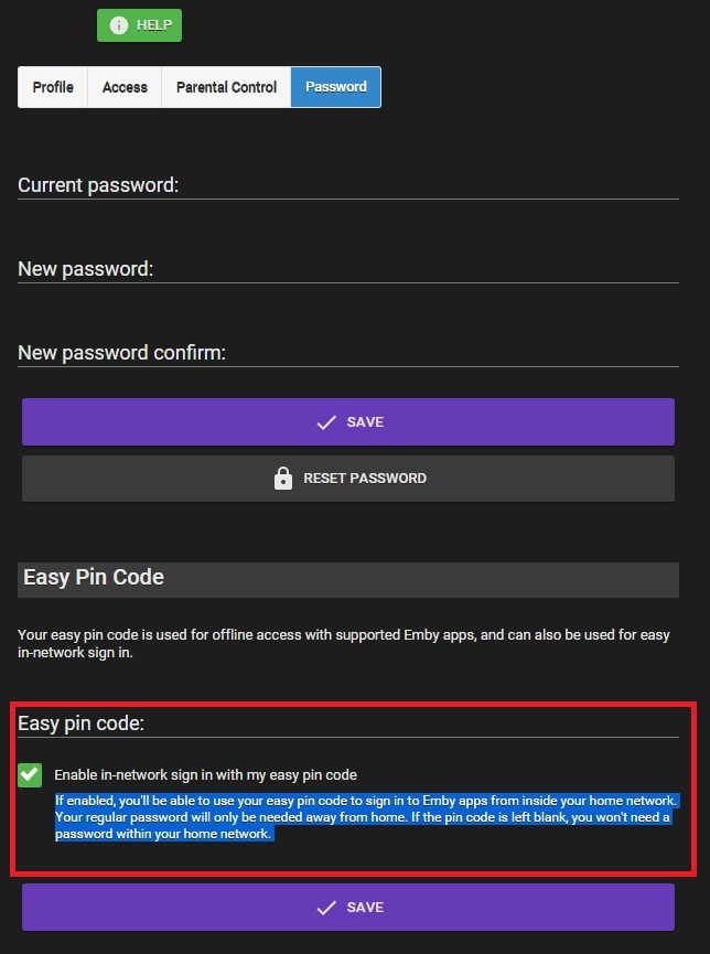

Happy2Play 9800 Posted October 20, 2015 Posted October 20, 2015 Set a user password, then check easy pin.

MSattler 390 Posted October 30, 2015 Posted October 30, 2015 thanks Happy. Any recommendations of settings for routers, firewalls? I did change the default port of 8096, but i'm guessing that doesn't do much As long as users are going to remotely access your Emby server there is not a ton you can do on the firewall/router. Even with moving the port, all I would do is port scan you to see what ports you are listening on. Set a password with easy pin and that should protect the user accounts. I would also make any admin accounts not visible at the login page, and not name the account admin or administrator. That will keep from someone brute forcing the admin accounts.
