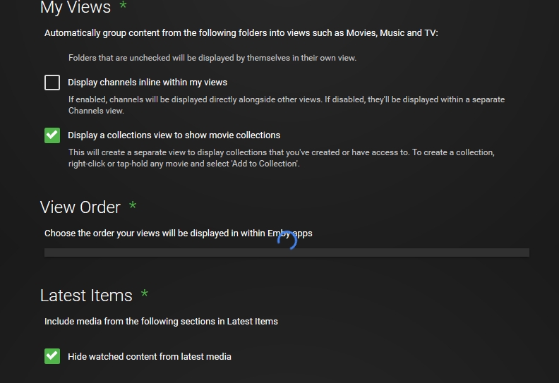

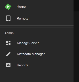

Bert-KS 3 Posted October 18, 2015 Posted October 18, 2015 I updated to the new beta 3.0.5768.1 this morning and now I cannot see any libraries at all on any device (browser from a PC, Android app, Emby for WMC). Happens for all users on the server. Clicking on my user and going to Setting, Home Screen Settings shows the circle nonstop and the View Order is not available at all: The CPU load goes to 100% when this happens. I tried FF and IE with the same results, the same on the Android app. Just the circle with no View Order. I also cannot change any settings under Home Page in this screen. Clicking on save says it has saved it, but it didn't. Going back to any other screen in Emby still shows the circle from now on until I restart the browser window. The side bar does not show any libraries either. It used to show all libraries between the two lines: The libraries themselves seem to be fine and correctly setup. I tried the Clean Database and rescan the library without any improvement. I also have re-installed the server again, not helping either... Any advice on this issue please? Thank you! server-63580798253.txt

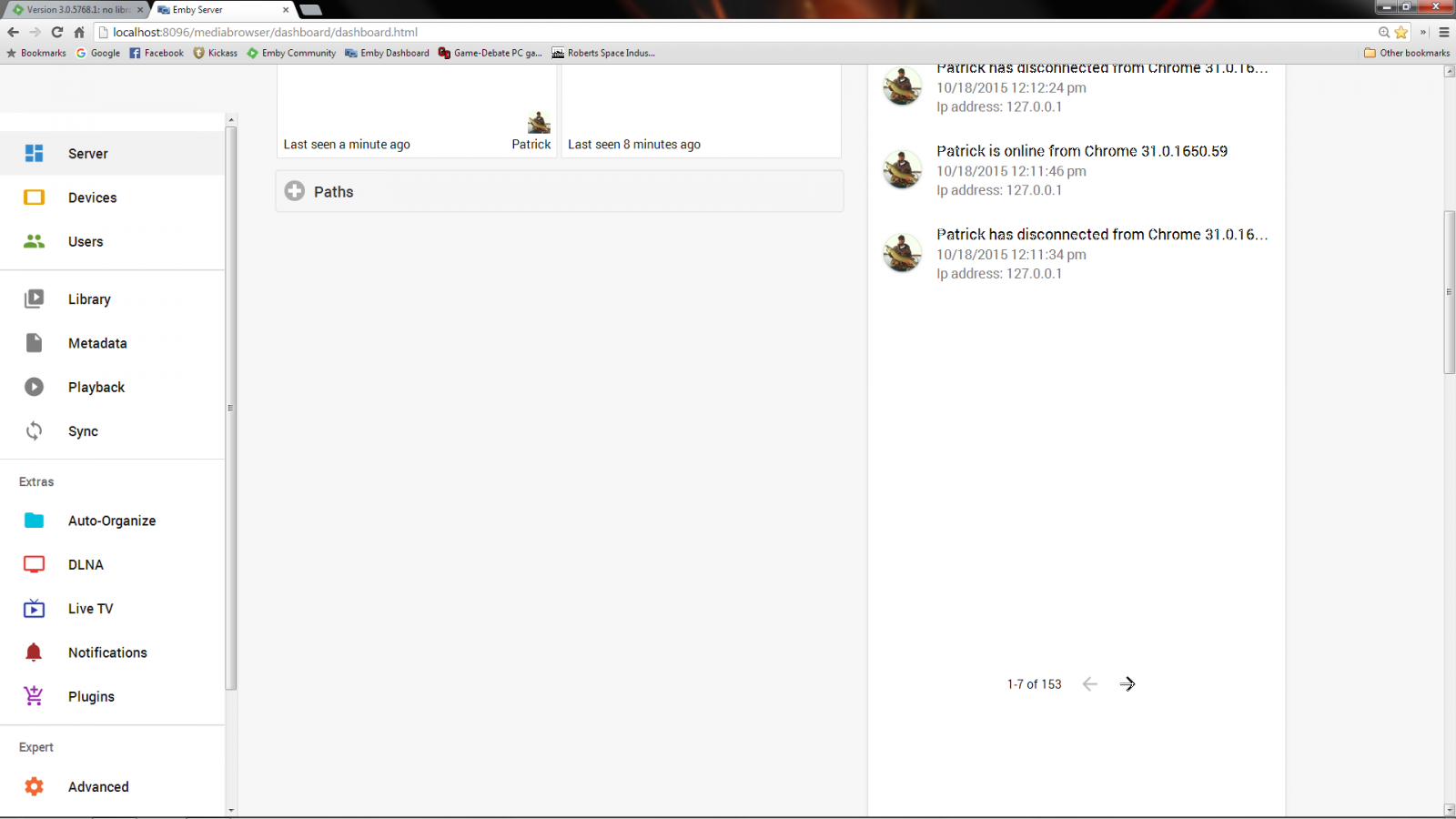

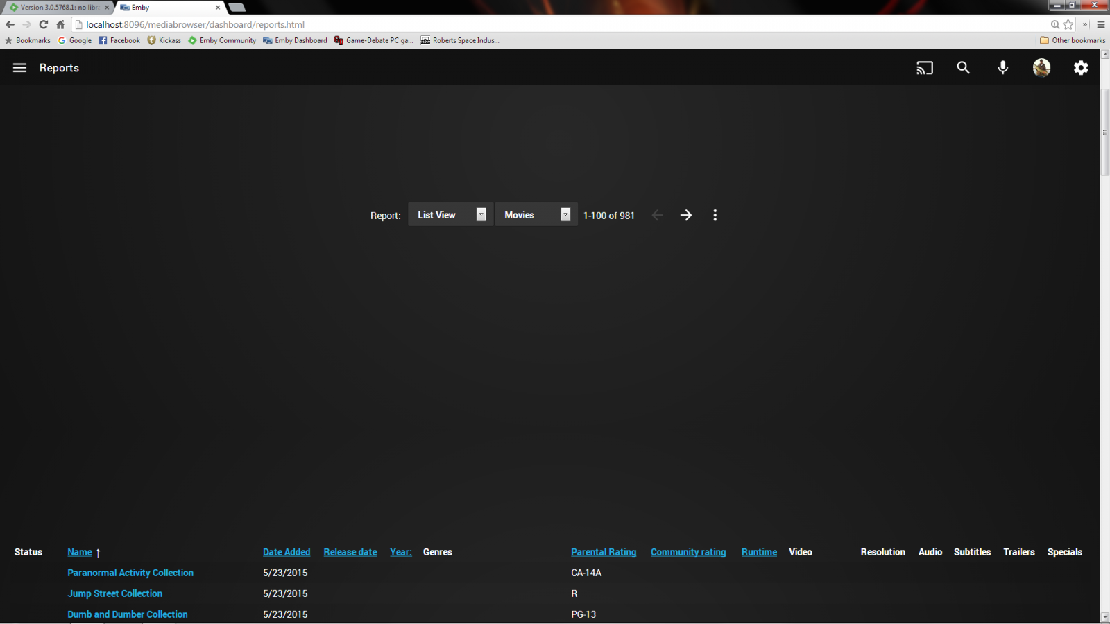

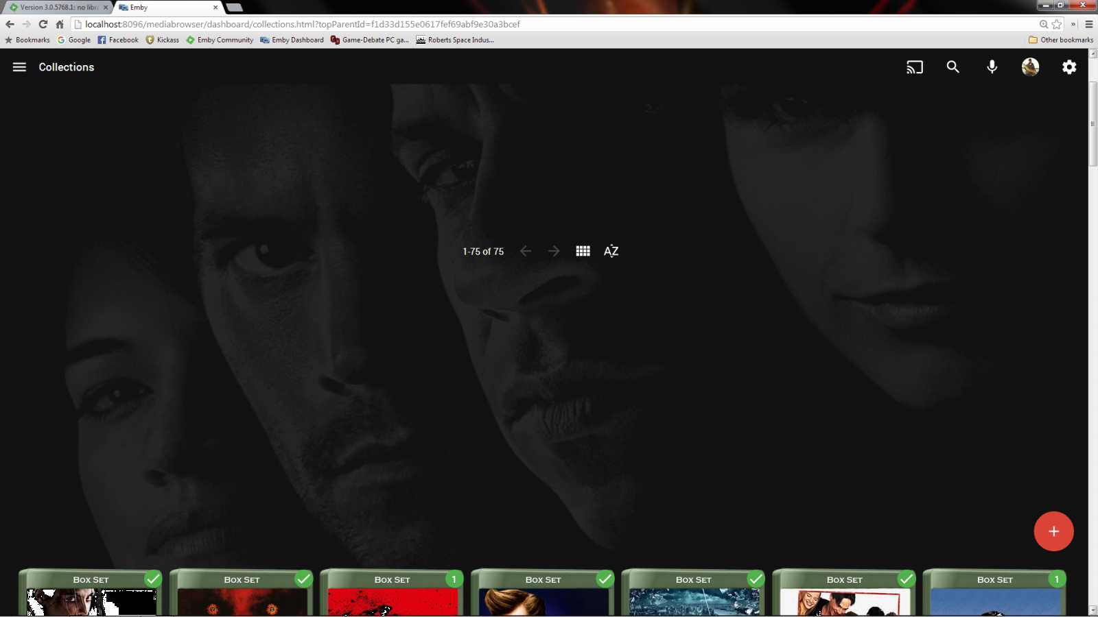

pmac 143 Posted October 18, 2015 Posted October 18, 2015 I tried starting a new topic about the spacing issues I'm having 3 times now, and each time when I try to post it, I get sent to the thread listing, but my thread doesn't exist, so I'll try to post as a comment here (sorry for derailing this post) The issues I mentioned above only seem to happen in Chrome, IE is displaying the WebUI just fine for me. The last 3 screenshots show how the spacing seems to grow exponentially as I zoom out: (EDIT: apparently I can't post .PNG images from dropbox)
Luke 42185 Posted October 18, 2015 Posted October 18, 2015 in the meantime i guess you can describe where it's happening. i don't see anything like tthat on chrome 47
pmac 143 Posted October 18, 2015 Posted October 18, 2015 (edited) what version of chrome? 31.0.1650.59 m I wasn't having this issue with the latest official release, but I was having the library not displaying problem. Edited October 18, 2015 by pmac
Luke 42185 Posted October 18, 2015 Posted October 18, 2015 ok, i see from your home page. looks like you're on 31. that's really old. the stable channel is currently up to 46 now. the web client is moving forward with a number of new technologies. for browsers such as chrome that have auto-update features, you need to run a relatively recent version. Up to 5 versions behind is probably a reasonable number for us to support. chrome 31 was released in November 2013. 1
pmac 143 Posted October 18, 2015 Posted October 18, 2015 ok, i see from your home page. looks like you're on 31. that's really old. the stable channel is currently up to 46 now. the web client is moving forward with a number of new technologies. for browsers such as chrome that have auto-update features, you need to run a relatively recent version. Up to 5 versions behind is probably a reasonable number for us to support. chrome 31 was released in November 2013. Wow! I didn't realize I was that far behind haha. I'll update and see what happens. It's strange that I'd have such an old version, considering I just built this computer in February...
pmac 143 Posted October 18, 2015 Posted October 18, 2015 I was able to install Chrome 46. For some reason, auto-updates isn't working for me with Chrome, keep getting error code 7, unable to install. But with installing v46, the server is displaying correctly. Thanks. 1

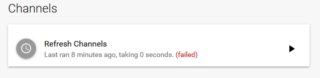

Bert-KS 3 Posted October 18, 2015 Author Posted October 18, 2015 (edited) The server has now updated to Version 3.0.5768.2 overnight, the problem still exists though. I've downloaded this new version again and installed, still no channels... Afterwards, I noticed the Refresh Channels did not go through and failed: The logfile for this moment is attached, the notification email says Sequence contains no matching element However, the Library Scan is still going this time, while before it took only a few minutes to complete, so fingers crossed it will self-correct the database this time. Thank you so far, I'll report back... server-log.txt Edited October 18, 2015 by Bert-KS

Luke 42185 Posted October 18, 2015 Posted October 18, 2015 Thank you. That channels issue has been resolved for the next beta revision.

Bert-KS 3 Posted October 19, 2015 Author Posted October 19, 2015 Update: Refresh Channels still fails:
