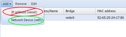

Solution Cerothen 98 Posted October 11, 2015 Solution Posted October 11, 2015 (edited) Good Morning All,I have gone back into my setup this morning and am here to present my findings. Under openvz/proxmox(container) you must use a bridged interface rather than the routed interface to be able to control DLNA devices on the network. Once you remove the original routed interface and add a bridged interface you can then start up the VM and make sure that the interface appears with the command "ifconfig -a" (http://www.tecmint.com/ifconfig-command-examples/). If you see your interface use the command: nano /etc/network/interfaces There you can specify the appropriate parameters to outline your static ip as explained in detail here https://wiki.debian.org/NetworkConfiguration. for me I entered: auto eth0 iface eth0 inet static address 192.168.10.11 netmask 255.255.240.0 gateway 192.168.10.1 you might also need to specify some dns servers: nano /etc/resolv.conf and enter something like: nameserver 8.8.8.8 nameserver 8.8.4.4 The results for me are that I can see and control my DLNA devices just like when I had Emby on windows: I hope that helps you with your emby container! Have a great Thanksgiving (Canada!) Edited October 11, 2015 by Cerothen 1
nyanloutre 3 Posted October 11, 2015 Author Posted October 11, 2015 (edited) Thanks ! I will try it as soon as I can EDIT : It works, thanks ! Only one bug, if I launch a playlist on an audio Dlna receiver I can't see the playlist in the web interface however I can still switch to the next song Edited October 11, 2015 by nyanloutre
