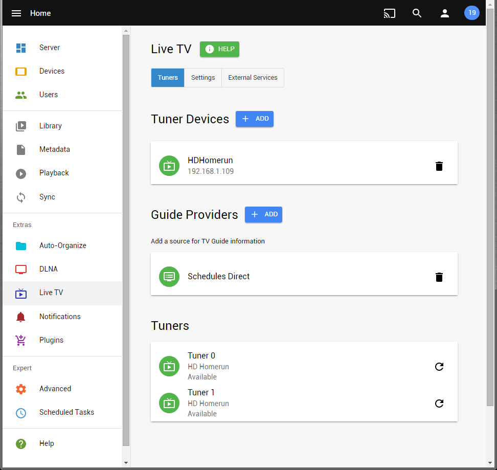

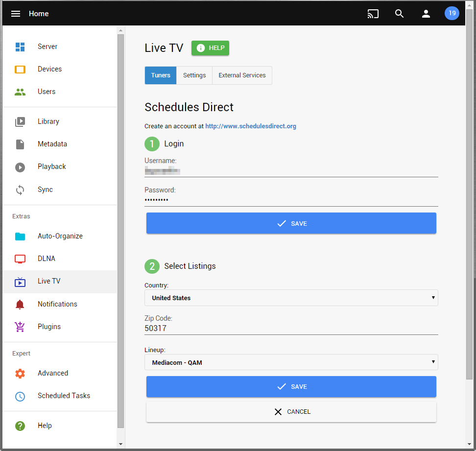

BrianG 11 Posted October 1, 2015 Author Posted October 1, 2015 ok. there's not even any schedules direct activity in the log so it appears you don't even have that setup right now. double check that first. See the attached screenshots showing both the tuner and SD account all set up. Like I said, it was working a few days ago and suddenly stopped working. The only changes on the server was maybe a windows update, but that's it (Win7).
Luke 42241 Posted October 1, 2015 Posted October 1, 2015 oh, this is why. your hdhr returned 0 channels http://192.168.1.109/lineup.json i think there was an hdhr change and people are going to have to be made aware of this http://emby.media/community/index.php?/topic/25875-no-guide-data-or-channels-in-livetv/

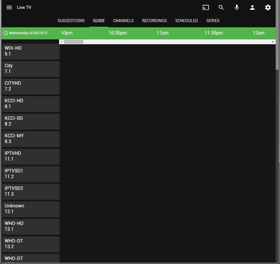

BrianG 11 Posted October 1, 2015 Author Posted October 1, 2015 (edited) The thing is, I did that setup as described when I installed this thing a while back and I do get data from the lineup.json url. And I haven't updated the HDHomeRun software since it was installed about a month or so ago. So, I completely removed the tuner and my SD account in the dashboard, restarted the Emby service, and re-entered everything exactly as it was before. Running the LiveTV scheduled task took about the same amount of time, and now I see the list of channels, but not what is playing, as shown in this screenshot. Not quite right, but better than absolutely nothing, so some progress is being made. EDIT: Since I've tried refreshing the guide so many times during this process, I wonder if my SD account has been flagged as being abused? Edited October 1, 2015 by BrianG
