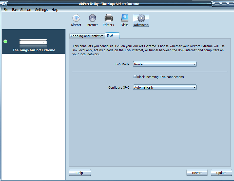

TheKings 0 Posted September 24, 2015 Author Posted September 24, 2015 That's what I'm told by my ISP. They said they were not blocking port 8096. I have attached a photo of the AirPort Utility showing it is set to bridged.

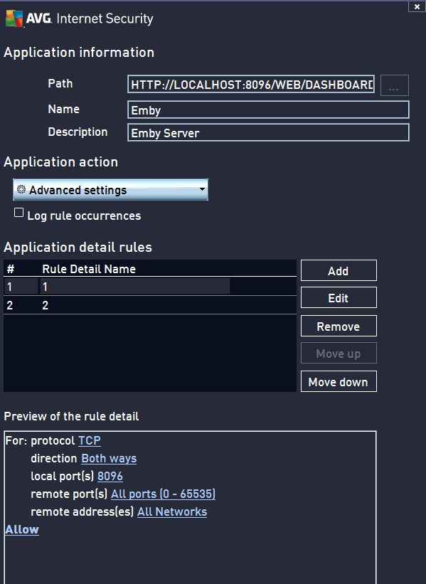

TheKings 0 Posted September 24, 2015 Author Posted September 24, 2015 Here is the set up for AVG Internet Security Firewall: I have these two rules set up on each of the three emby listiings. Is this correct?

Happy2Play 9814 Posted September 25, 2015 Posted September 25, 2015 I don't use AVG so I don't know, but those don't look right to me. Don't know how well this applies to current versions. http://fixmyavg.blogspot.com/2011/11/how-to-open-specific-port-in-avg.html
ebr 16354 Posted September 25, 2015 Posted September 25, 2015 Yeah, the path to our server application is an URL. That should be the path to the actual MediaBrowserServer.exe file...
TheKings 0 Posted September 25, 2015 Author Posted September 25, 2015 I don't use AVG so I don't know, but those don't look right to me. Don't know how well this applies to current versions. http://fixmyavg.blogspot.com/2011/11/how-to-open-specific-port-in-avg.html Actually, this link is the one I used to set up my AVG.
TheKings 0 Posted September 25, 2015 Author Posted September 25, 2015 Yeah, the path to our server application is an URL. That should be the path to the actual MediaBrowserServer.exe file... where will I find this?

ebr 16354 Posted September 26, 2015 Posted September 26, 2015 It's the first one with the proper icon - MediaBrowser.ServerApplication.
ebr 16354 Posted September 26, 2015 Posted September 26, 2015 Nothing happens when I double click the MediaBrowser.ServerApplication file. That is the item you should be pointing your AVG firewall to to setup the rules. When are you talking about double-clicking it...?
TheKings 0 Posted September 26, 2015 Author Posted September 26, 2015 (edited) OK, I added the MediaBrowser.ServerApplication as the file my AVG points to. I have both TCP and UDP allowed on port 8096. Still no luck connecting though. I tried rebooting the computer after I changed AVG just to check if I could log on. I appreciate all the help so far, I honestly don't know what the issue is. Edited September 26, 2015 by TheKings
Happy2Play 9814 Posted September 26, 2015 Posted September 26, 2015 Does your Motorola have any of the firewall options enabled?
TheKings 0 Posted September 26, 2015 Author Posted September 26, 2015 I don't think so, and It is running in bridged mode. Here are the screenshots I think you want to see.
