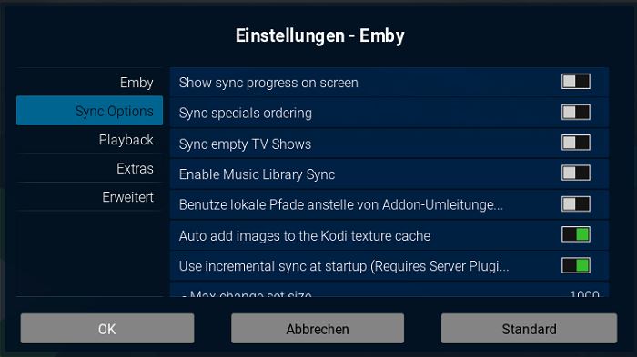

Tranquil 95 Posted September 15, 2015 Posted September 15, 2015 Hello Devs. Yesterday I got an updates of Emby Addon which also offers the Emby Server Sync Queue. I installed the plugin on my server, did a restart and enabled this option in the syncing parameters of the addon. Anyway, I can not see a difference between enabling this option or not. There is always a sync of all my Folders, which are available for these users (not every folder is available for every user) when I startup Kodi. Is that intended? I would assume that the Addon requests only newly added/ changed elements and not going fast through my whole library.

Angelblue05 4132 Posted September 15, 2015 Posted September 15, 2015 There's no mention of the plugin option being enabled. Can you make sure the plugin option is enabled for all your profiles you want to use the server plugin with, in the Emby for Kodi add-on settings > sync options? Normally, this line should appear, but doesn't so my guess is you didn't press save after enabling it: Sync Database -> Using incremental sync instead of full sync useIncSync=True)
Tranquil 95 Posted September 15, 2015 Author Posted September 15, 2015 (edited) It is correctly enabled on all two user profiles I have in KODI (can see it enabled in the settings of the addon). So reloading of this setting and displaying it in the settings menu is correct. Re-Enabling, Saving, Restarting does not solve this. Edited September 15, 2015 by Tranquil 1
