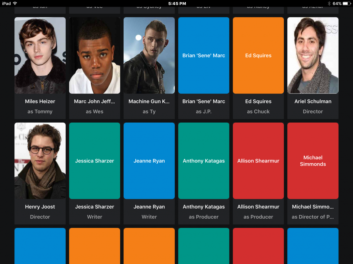

mata7 45 Posted October 21, 2016 Posted October 21, 2016 remove or hide from ios app and android and also from AndroidTV app, it just dont look rihgt this is what i mean and it look the same on Ipad nexus or nvidia shield
ebr 16309 Posted October 21, 2016 Posted October 21, 2016 At one point, Emby Theater only showed actors that had images and then a lot of people complained that they were missing. Another problem is that, since the images are loaded on demand (and we simply must do this) we don't know whether or not they have an image until we display them. And, as i said above, they may gain an image at some point in the future. The only thing you could do is remove them from the source but that isn't really practical and will be overridden by any kind of refresh.
Luke 42197 Posted October 21, 2016 Posted October 21, 2016 Emby Theater still does that, so perhaps an option to hide them is best.
Happy2Play 9802 Posted October 21, 2016 Posted October 21, 2016 Theater still hides missing actors, was just testing this, at least the desktop app. This is where the Cast and Crew need to be reworked since there are so many available/added to the movie metadata. Do we really need almost all the credits? There needs to be an option to exclude as I request here.
mata7 45 Posted October 22, 2016 Posted October 22, 2016 Emby Theater still does that, so perhaps an option to hide them is best. i dont know how hard that will be, but can you please add the choice of hide on all apps if is posible please thank you
ebr 16309 Posted October 22, 2016 Posted October 22, 2016 Yeah it would be best at the server level. However I would want to be sure it didn't mean you never got an image for someone in the future.

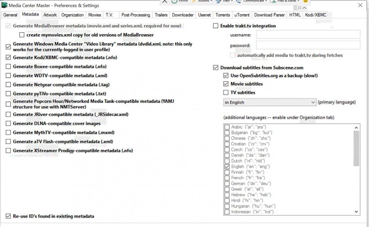

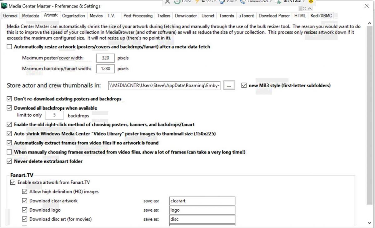

phoenixaus 3 Posted January 13, 2017 Posted January 13, 2017 Thanks Guys for the quick responses! If it helps, I have Media Centre Master source images, The XLM for the people on my install is \AppData\Roaming\Emby-Server\metadata\People If I look at Will Smith for example, it is located in a folder W\Will Smith. Within the folder is an image called folder.jpg and a person.xml file with the following entry: <?xml version="1.0" encoding="UTF-8" standalone="true"?> -<Item> <Added>10/08/2016 7:06:18 AM</Added> <LockData>false</LockData> <LocalTitle>Will Smith</LocalTitle> </Item> Within with library options, I have the following attached settings: Is the Bio information downloaded on demand (ie when that cast member is shown on Emby) or is it downloaded and stored? Thanks! Library.pdf
