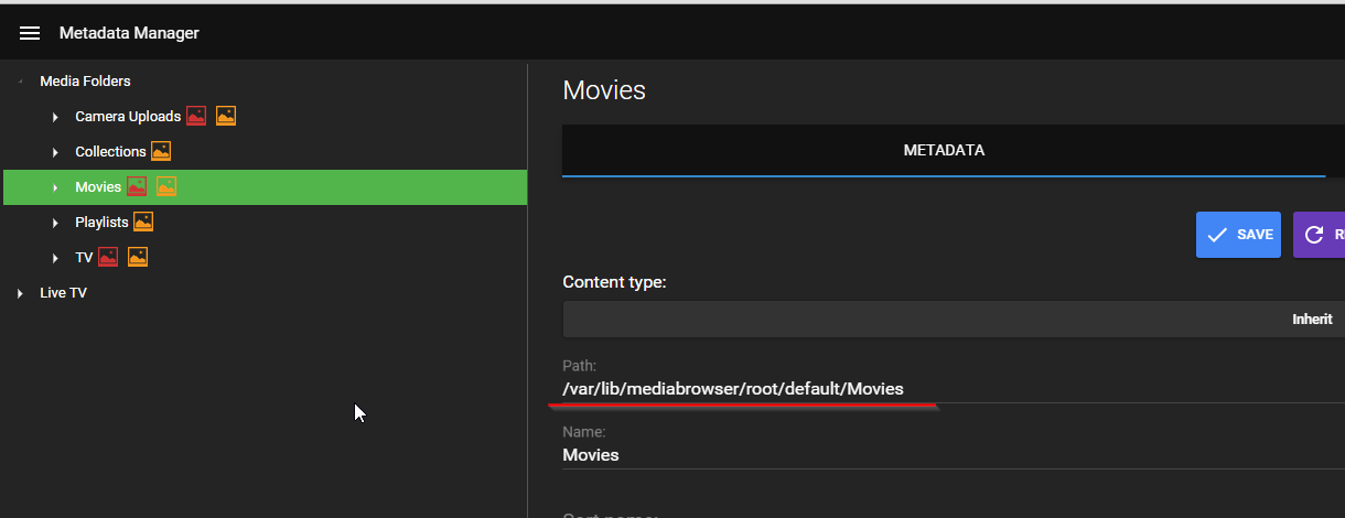

KingDaveRa 2 Posted September 12, 2015 Author Posted September 12, 2015 Just tried that, and it's made no difference. I also tried removing it, then scanning, then adding it back, also no luck. However, I just found my way into the Metadata Manager, and saw this: That's the old path. Is that editable somehow? If the databases are sqllite I can do that. Is it likely to be stored somewhere else, perhaps? Of course, the slightly less elegant way out of this is to just symlink the directory, but I'd rather get the paths all the same and be a in position for future upgrades.

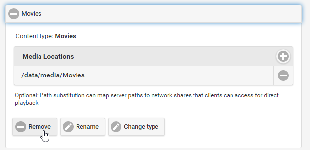

Luke 42243 Posted September 12, 2015 Posted September 12, 2015 ok, rather than remove the paths, try removing the entire library trees from setup. just try one. then add it back.
KingDaveRa 2 Posted September 12, 2015 Author Posted September 12, 2015 Do you mean from here: Because I already tried that, but no joy.
