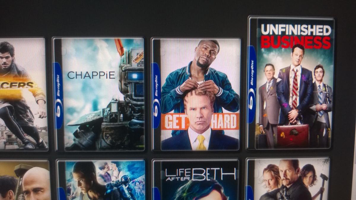

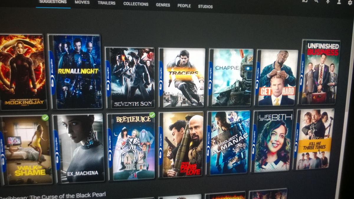

XiaNYdE 13 Posted September 6, 2015 Posted September 6, 2015 I just updated to the new Version 3.0.5724.3 and covertart updated straight after, now anything i add to my library is showing smaller images is there any way to correct this behaviour? If i revert back to the previous version images return to correct sizing. Also it's not just in the latest movies, if i browse through the library anything just added will display the smaller image size, i have not made any changes to coverart settings they are exactly as they were prior to the update.

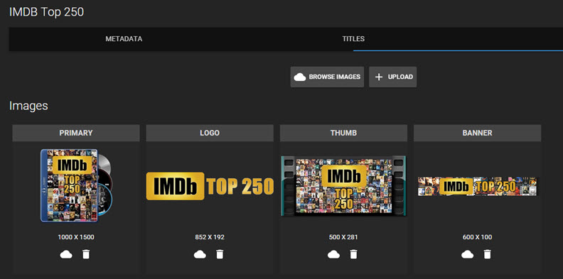

Smaky 131 Posted September 7, 2015 Posted September 7, 2015 What I have noticed is that images that look shorter will not have height and width reported in metadata editor. For some reason I have had to edit the images and manually upload them to the item so dimensions are picked up by Emby and then they get resized appropiately.
XiaNYdE 13 Posted September 7, 2015 Author Posted September 7, 2015 (edited) Not positive what version you came from so not sure what may have changed but probably a bug was fixed. If you were to refresh the old covers, they probably would get the same size treatment. Do you have "use original art aspect ratio" checked? updated from 3.0.5675.1 ebr and no i don't have "use original art aspect ratio" checked up unti the latest update all images looked the same as the ones on the far right after the update everything added has the shorter image applied, also as i said if i revert back to 3.0.5675.1 the images return to the size i am used to seeing. Edited September 7, 2015 by XiaNYdE

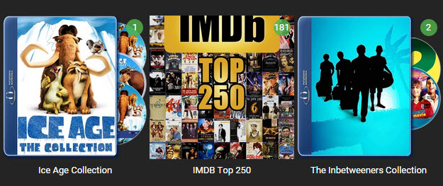

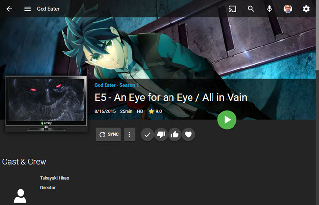

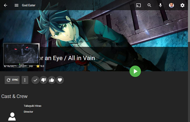

Smaky 131 Posted September 7, 2015 Posted September 7, 2015 Look at this sample. When the image is uploaded from the web using the metadata editor, it shows no dimension... Then the web client gets messed up with the title (resizing the browser does not help)... Now I just open the file in PaintShop Pro and save it again, then upload it manually... Now dimensions show up in metadata editor... (notice without saving the file I get the same results by saving the image locally and uploading. Saving it with PSP -or any other image editor- is necessary). And now the web client shows properly. Seems to me the web client is looking for something within the image itself that in recent versions is not getting from them and that previously might have been handled differently, this in turn may be affecting rendering in the web client.

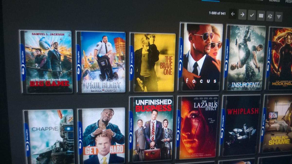

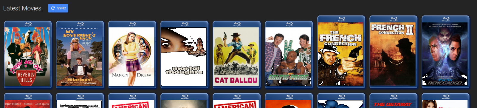

barrettuk 3 Posted September 8, 2015 Posted September 8, 2015 Not sure if this is a server issue or web client but in the web client the new movies I just added have a smaller cover than before but it looks normal in the media center add-on and the Windows App. Was something recently changed?

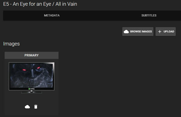

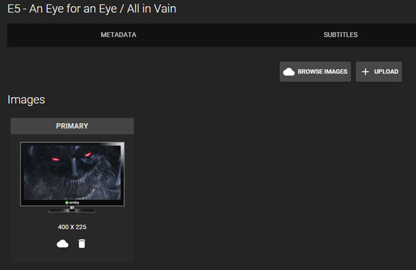

barrettuk 3 Posted September 13, 2015 Posted September 13, 2015 (edited) What I found is that if the web client would not show image dimension in the metadata editor, then the issue appears and the image in the web client will be smaller. Not sure why this happens. I can confirm the same - the image dimension is not being displayed on the new movies which then show smaller in the web client - can someone PLEASE fix this? UPDATE: for now I am opening the file in a photo editor, saving, then manually uploading the primary image and it captures the dimensions and displays correctly in the web client! Edited September 13, 2015 by barrettuk
XiaNYdE 13 Posted September 14, 2015 Author Posted September 14, 2015 I can confirm the same - the image dimension is not being displayed on the new movies which then show smaller in the web client - can someone PLEASE fix this? UPDATE: for now I am opening the file in a photo editor, saving, then manually uploading the primary image and it captures the dimensions and displays correctly in the web client! Yeah i'd like to know as well if this is being looked at, unlike you i am too lazy to constantly open and save new images in photoshop lol so i've reverted back to an older version until a fix becomes available.
XiaNYdE 13 Posted September 14, 2015 Author Posted September 14, 2015 Just decided to check what other had been saying now that i had another movie to add, so updated back to latest version, added the film and indeed the artwork showed with no dimensions at all and displayed a smaller cover in the WebUI, so i opened it in photoshop saved it as a .png and uploaded it, dimensions showed and correct size cover displayed in the WebUI.
