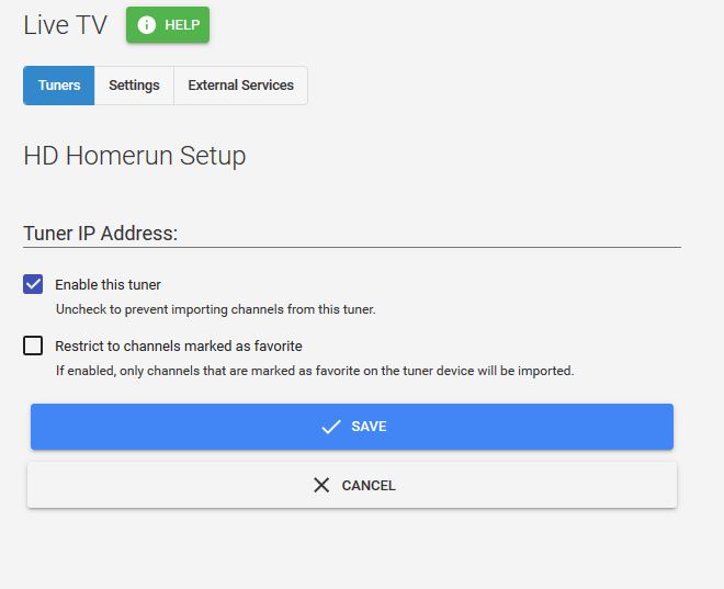

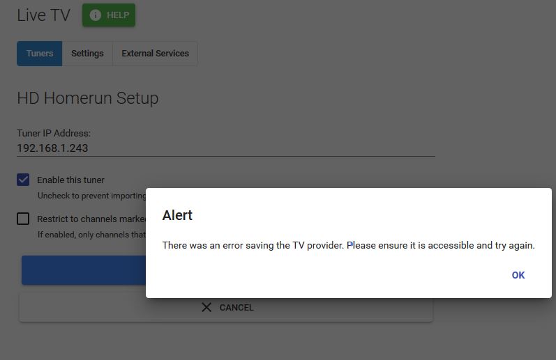

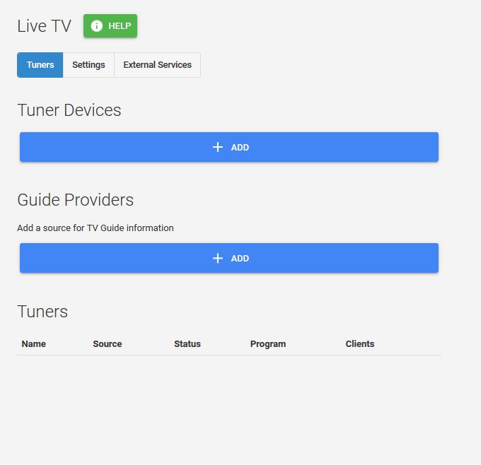

chuga 4 Posted August 23, 2015 Author Posted August 23, 2015 thanks for the quick replies see attachements: Pic1 - screen I get at start pic 2 - after I choose "hdhomerun" nothing is autodetected. I enter in the IP manually and click "save" pic 3 - the error I get after clicking "save" Do I need to add a guide provider before trying to add the hdhomerun? after clicking "hdhomerun" the option to add a guide provide is not there (pic 2) thanks
Luke 42243 Posted August 23, 2015 Posted August 23, 2015 You're doing it perfectly fine, in all likelihood the server just can't reach that ip address. see http://emby.media/community/index.php?/topic/790-how-to-report-a-problem/ also - what is your hd homerun model?

mellomade 141 Posted August 23, 2015 Posted August 23, 2015 its a "dual" model see attached for last few server logs Live TV only works with the newer DLNA capable HDHomeRun models (CONNECT, EXTEND, and Prime). The Dual (HDHR3) is not DLNA capable. 1
