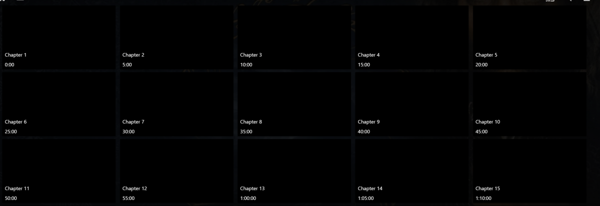

dcauger 3 Posted December 16, 2017 Posted December 16, 2017 I am having a similar problem. Scene images are missing for both Roku and when accessed via a browser. Seems to of started right around 11-18-17. Playback works fine from the scenes, just the images for the scenes are gone. much of my collection previous to 11-18-2017 is missing the scene images. Everything added after 11-18-17 has the images. Is there a database i can delete that houses the scene images and let it rebuild? or some clean-up process i can run?

dcauger 3 Posted December 22, 2017 Posted December 22, 2017 I have ran the scheudled task "chapter image extraction" several times. It completes in a few seconds. I've attached a screen snip of a movie as an example of what I see. There is a black box where the image used to be. If I select one to play from that point, it will play fine - just the image is missing. I know this is not a big deal in the whole scheme of things and it seems I am the only person with this problem. If there is a database somewhere i can delete that contains these images, i can do that and let Emby recreate that database through a new image scan. That said, i would like to avoid deleting the library.db. Mine is slightly larger than 600MB in size. last time i did that it took a long time to re-populate.
dcauger 3 Posted December 22, 2017 Posted December 22, 2017 the one above was an MP4. It does not matter if its an .mkv or an .avi.. it is not limited to movies, it can be an episode (for me, episode are in a different library). what seems to matter is the date. Anything after 11/18/17 has scene images, items before do not appear to have scene images (I can not tell you if its every item before 11/18/17 - some analysis lead me to the date of 11/18/17. i've not checked everything in all of the libraries). Thank you for the continued support! DCA
dcauger 3 Posted December 28, 2017 Posted December 28, 2017 Update - (perhaps this is a bit obvious) if I move an item (movie, episode) out of a library, scan the media libraries, move the item back it to the library where it originally was, re-scan the media libraries, the scene images populate correctly. I would assume this behavior normal as emby would purge the moved item from its database(s) and re-add the item when its re-discovered. What I did not expect was that the "added" date was not changed from the original date the item was added to the library (say, 10/21/16). The item did not show up as a "latest movie" either. This is good as I can follow this process for large chunks of the library and fix my problem over time (without deleting library.db and starting over). before i do that and possibly break something else, I would like to vet out if there is a specific database I could delete that holds just the scene image data? Or, if there is some other process I should follow. Thank you, DCA
Luke 42243 Posted December 28, 2017 Posted December 28, 2017 the added value is stored in nfo metadata files, so if you preserved those files then that. if there is no nfo metadata, then it's based on the date created time stamp of the file. under the server's metadata folder there are sub-folders for library items, and each item has a chapters folder with images. you could probably do a search to delete all those chapters subfolders, then run a library scan.
