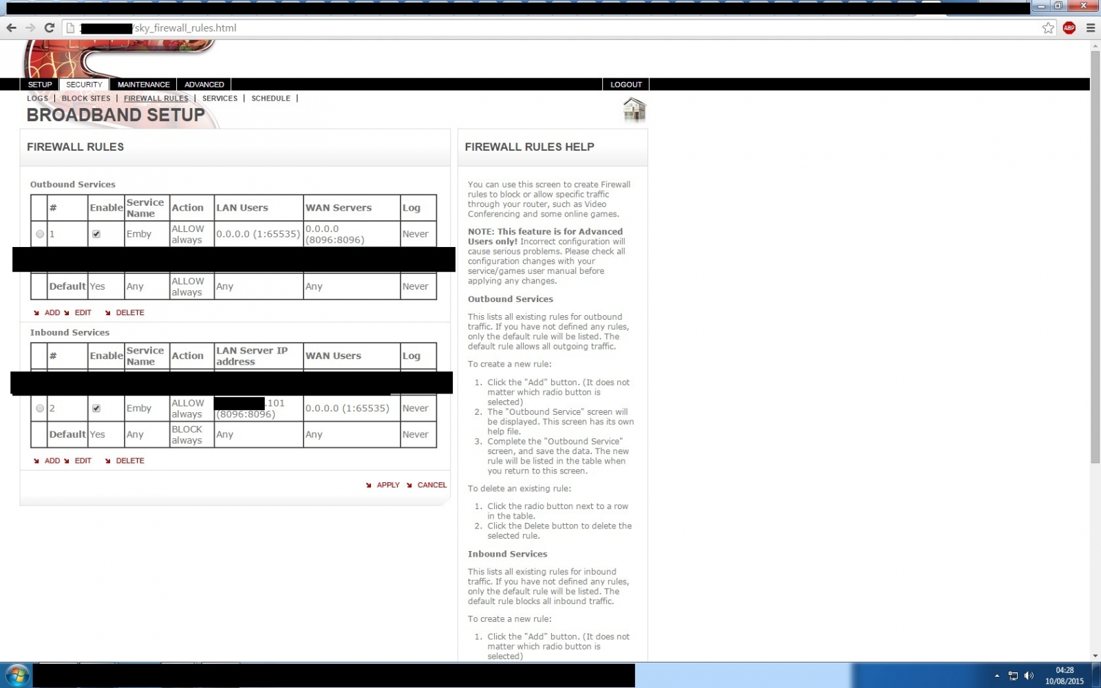

I seem to be having issues using the Media Browser, when selecting my server. After attempting to connect I am greeted to this:
After Selecting number 1.
All three cant connect though I only need/want "SobaniEmby" I have tried deleting the other two as they were linking to my other computers before deciding I'm going to dedicate one sole computer to my network programs. They wont delete. The loading circle will pop up, do its animation for about 2 seconds then goes. As if the process was completed.
The only way I can connect to the Media Browser is if I use the host computer which is running the server. Or strangely my Samsung Galaxy S5 Android, but only if it's connected to the Wifi. If I connect to 4G it gives me the same error as trying to connect on this computer (I'm writing this thread/topic on and trying to remotely connect to Media Broswer/SobaniEmby).
Additionally.Trying the Remote Access url tells me the webpage is not avaliable due to the connection attempt, timing out with :8096 and /mediabrowser added. Without causes me to connect to my modem's local page.
Both the host computer and this computer are connected via eithernet cable straight to the Modem. No routers or connection bridges are involved in this network. Two wires, two computers, one DSL Modem into the phoneline. I have checked to see if the firewall rules are correct. Both Port 8096 and "mediabrowser.serverapplication.exe" (UTP & TCP) are enabled for all private, public and domain connections. Both inbound and outbound. I have also configured my Modem in my opinion, correctly. - For forwarding the port 8096 and the i.p for both TCP and UDP. I have set also a static i.p for the host computer. By using this guide provided by my ISP - http://www.skyuser.co.uk/forum/content/167-port-forwarding-setting-up-port-forwarding-use-existing-set-up-custom-services.html & http://www.skyuser.co.uk/forum/content/180-ip-address-reservation.html
Emby Server is running on host computer. Both tested via localhost and Media Browser.
I've rebooted computers, reset the modem, done the needed config (as far as I'm aware of). Am I missing something out?
No inbound or outbound blocks are set on my modem firewall and the only inbound and outbound blocks in Windows Firewall that are set on either computers is on the host computer. Both an inbound and outbound block for a specific program completely unrelated to Emby and uses no ports. Was just to disable an updater that couldn't be disabled otherwise. Other than that, nothing.

Edit 1: Earlier, I did also make a second account for Emby Connect and gave all privileges to that account also. Sent the invite link and still, no dice. Root Admin account is Sobani Exile. User 2 is SobaniEmby. Not sure if that info would be required but in case it is. (Saves time waiting and writing replies with additional info that I need to add.)
Edit 2: I have briefly turned off my modem firewall. (Refering to the default "inbound block" shown on picture 3.) Reset modem and tried to access Media Browser again. Nothing changed. So I promptly re-enabled the Modem firewall for obvious reasons.
