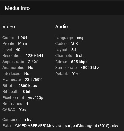

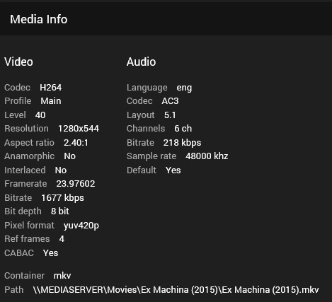

mjktg99 35 Posted August 18, 2015 Posted August 18, 2015 I can now get into the app. I am having random playback issues as well. Video failed to play (not everything). I have 2 movies that are almost the same and only 1 plays. ex Machina plays, while Insurgent will not.
