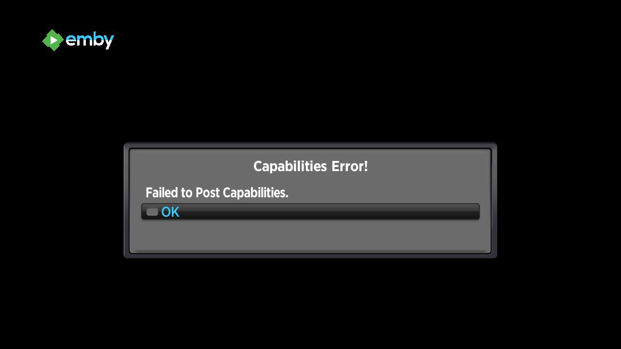

knowlzy10 0 Posted February 2, 2017 Posted February 2, 2017 On now tv box I'm getting attached picture error now, I'll just roll back to a previous working version.

mediacowboy 438 Posted February 3, 2017 Posted February 3, 2017 Sideloaded V4.05 to see why it wouldnt log me in. I never get the new app setup. It just detects my server and logs me in but I am getting the following errors. Nothing is loading and getting the Capabilities Error. Debug Windows: ------ Running dev 'Emby Blue Neon Night' main ------ BrightScript Micro Debugger. Enter any BrightScript statement, debug commands, or HELP. Current Function: 1324: function MissOrUp(i as Object) as String 1325: tr = CreateObject("roDateTime") 1326: r = CreateObject("roRegex", "T", "") 1327:* dt = r.Split(i.PremiereDate) 1328: releaseDate = dt[0] 1329: if releaseDate = invalid then releaseDate = i.StartDate 1330: 1331: ' missorup is always episodes Type Mismatch. (runtime error &h18) in pkg:/source/GeneralMetadata.brs(1327) 1327: dt = r.Split(i.PremiereDate) Backtrace: #6 Function missorup(i As Object) As String file/line: pkg:/source/GeneralMetadata.brs(1327) #5 Function getmetadatafromserveritem(i As Object, imagetype As Integer, primar yimagestyle As String, mode As String) As Object file/line: pkg:/source/GeneralMetadata.brs(275) #4 Function parselivetvprogramsresponse(response As Dynamic) As Object file/line: pkg:/source/LiveTvMetadata.brs(84) #3 Function parsehomescreenresult(row As Integer, id As String, startindex As I nteger, json As String) As Object file/line: pkg:/source/HomeScreen.brs(766) #2 Function loaderonurlevent(msg As Dynamic, requestcontext As Dynamic) As Void file/line: pkg:/source/PaginatedDataLoader.brs(218) #1 Function vcshow() As Void file/line: pkg:/source/ViewController.brs(647) #0 Function main() As Void file/line: pkg:/source/appMain.brs(21) Local Variables: i roAssociativeArray refcnt=4 count:16 global Interface:ifGlobal m roAssociativeArray refcnt=5 count:31 tr bsc:roDateTime refcnt=1 r bsc:roRegex refcnt=2 dt <uninitialized> releasedate <uninitialized> rd <uninitialized> hours <uninitialized> mins <uninitialized> match <uninitialized> hour <uninitialized> mi <uninitialized> stamp <uninitialized> t <uninitialized> local <uninitialized> l <uninitialized> tp <uninitialized> Brightscript Debugger>
