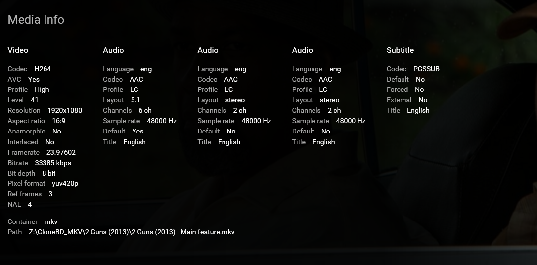

TomTiddler 39 Posted February 1, 2017 Posted February 1, 2017 @@speechles, a couple of questions/issues if u don't mind -- I'm running Blu Neon 4.04 (full) and having some transcode issues. The library in question contains .mkv rips of BluRays, all done with CloneBD. They're all H264, 1920x1080. Audio is either AAC or AC3 all 5.1 channels. If I have auto detection set, these always transcode. I should mention I've got a 1Gbit Ethernet setup, library is on a Windows server (WHS2011). If I set "Force DirectStream", everything plays fine, server shows I'm doing PlayDirect. Problem is when I leave the app and then go back in, the play method has been reset to AutoDetect, even though I have "ResetPlayMethod" set to NO. The settings I've changed from default are "ResetPlayMethod: NO" "MaxRelFrames: 16" "H264 Max Transcode Level: 51" "Max Framerate: 61" "Local Quality: 30Mbps" I tried 50, but it made no difference - player is a Roku 3 An example is "2 Guns", using "Auto detect" the Server screen shows "Transcoding (30Mbps) ts h264 aac" under the preview screen, the attached file shows the "Media information for that movie from the Emby library display. Any thoughts?
speechles 2062 Posted February 1, 2017 Author Posted February 1, 2017 (edited) @@TomTiddler It is the bitrate causing the transcode, the video bitrate is 33,385. If you set the maximum bitrate to 40mbit it should direct play. Keep in mind, you can always "Force Directstream" from the "more ..." menu found on any playable items detail screen. This will attempt to direct play without asking the server if it is compatible. If the video player encounters an error in the stream the app will fallback to 'force transcoding' on it's own. The video player is coded to fallback when video errors are found, and switches on-the-fly from direct to transcoding. If you change the "Fallback retries" to higher than 1, It will also try to work through transcode errors and restart the transcode session to work through them. EDIT: I see in another thread you mention these have no runtime. This will induce transcoding. The roku video player needs to know the length for the hls manifest to think it is not live streaming. In the absense of runtime you can only adjust the playback as far as the buffer has captured. You also cannot fast forward past the "realtime" spot where it is presently playing. This is because when the roku is fed a runtime of 0 it assumes it is a live stream. EDIT2: Now I see it, there it is. A roku3 cannot play AAC 5.1. This is the first audio track in your rip. For this to work directly, you would need to put a 2 channel AAC track first, and then AAC or AC3 in 5.1 as later tracks. This is the true reason for it transcoding on you. If you had a roku premier or better, these devices support AAC in 5.1. Using "Force Directstream" should let your video play directly, but at the cost of no sound heard, just silence. So yeah, keep in mind it is there, but it can only work with what the device is truly capable of. Problem is when I leave the app and then go back in, the play method has been reset to AutoDetect Yeah, this is by design. This is so if someone does leave the playmethod on something forever and forgets they have. They left it on "Force Transcoding" for example. I am the one hearing their complaints when things play poorly and always transcode. So that setting only affects the current session while the app is open. Once you change it from autodetect it wont change it, but each app start it will set it back to autodetect. I apologize again... Also, there are some AAC 5.1 streams that play on a roku3. I have a roku3 and a roku ultra so I can see the difference myself. I have not found a reliable way to detect if it is really bitrate or what it is that allows a roku3 to play AAC 5.1 when it says in [audio decode info] AAC: 2:0:0:1 (use device info button in app to see this) the roku3 cannot play them. It is something in the AAC 5.1 where the roku3 can downsample this on the fly to 2.0. If you had an AVR hooked up that reported what the audio was you would see this. So you will have to adjust this on your own until I can smarten up the autodetect. Edited February 1, 2017 by speechles
