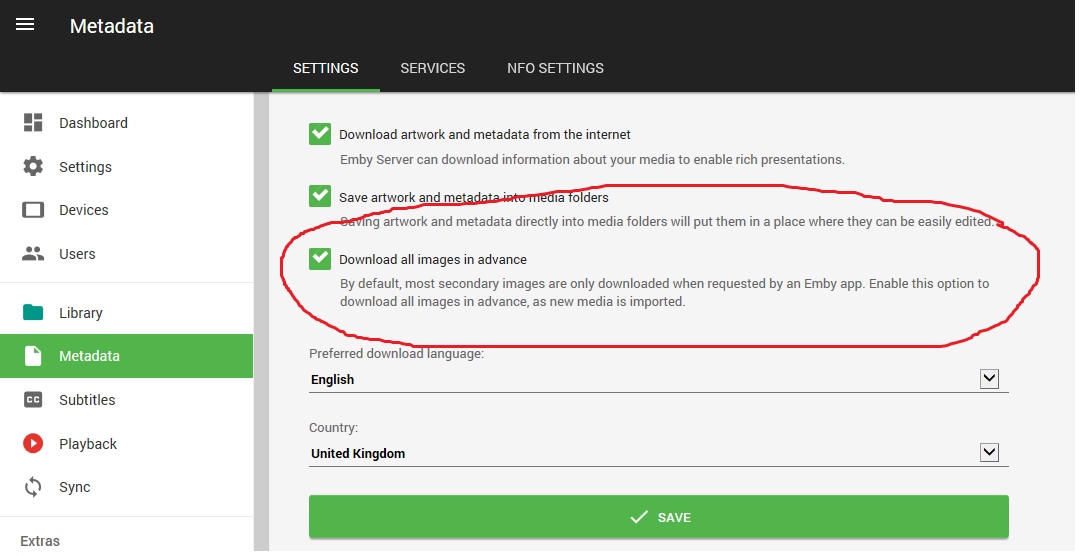

joshroblee 4 Posted June 10, 2016 Posted June 10, 2016 (edited) I had a similar problem a while a go, not sure if it is the same thing you have but this is something to try, check the load time for the images on a single movie/tv show then change the setting in the pic and put the tick in then refresh the said movie/tv show and see if it speeds up. Jamie PS, when I said refresh the movie/TV show I meant a full refresh with images. Edited June 10, 2016 by joshroblee
