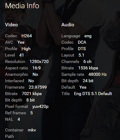

mickeyfinn 27 Posted October 10, 2016 Posted October 10, 2016 Just to provide information to support computerprep, I have had the same issue as he describes. I am using Android TV on a Sony Bravia 2015 model Smart TV. Watching for perhaps 20-30 mnutes, the playback will freeze and only pressing home will get me out of the app. Going back into emby shows the grey screen computerprep describes. I did not try force closing the app only because I did not see the option, but I had to restart Android to get it working again. I watched the same file again from the Continue point and another 20-30 minutes after the same issue repeated itself. I have not tried other files (still auditioning the Emby for Android TV app since I mainly use Emby for Media Center) but I am willing to help troubleshoot, provide data etc. if it will help. I do not know what version number I am using, but it showed as the latest available in the play store.
mickeyfinn 27 Posted October 10, 2016 Posted October 10, 2016 For further information, here is a screengrab showing information on the video I was trying to view when this happened.

mickeyfinn 27 Posted October 13, 2016 Posted October 13, 2016 So, I managed to do a bit more testing. Last night I viewed another file, after expanding the auto-logoff to 2 hours. I was able to watch without issue in excess of 2 hours. I watched the file that had the original issue again this morning (6:00 AM) and it froze up at 28 minutes in (a different spot than last time, but relatively close). I tried to back out of playback and it did so after a few seconds, but then went to the grey screen. I was able to force close and reopen the application again.
ebr 16337 Posted October 13, 2016 Posted October 13, 2016 Yeah, I didn't think the auto logoff would have any effect. Thanks for trying. Has your problem always occurred on this one video?
mickeyfinn 27 Posted October 13, 2016 Posted October 13, 2016 Yes, always on that one video. I haven't used the Android TV client for very long, but was hoping to transition over to it. I use Emby for WMC currently and plays this file through OK. Maybe it is just this one file but I haven't used it enough to know for sure, I would have to put in a lot more testing to verify, unless you have suggestions on the type of file to concentrate on? Maybe those with the same audio or video formats?
