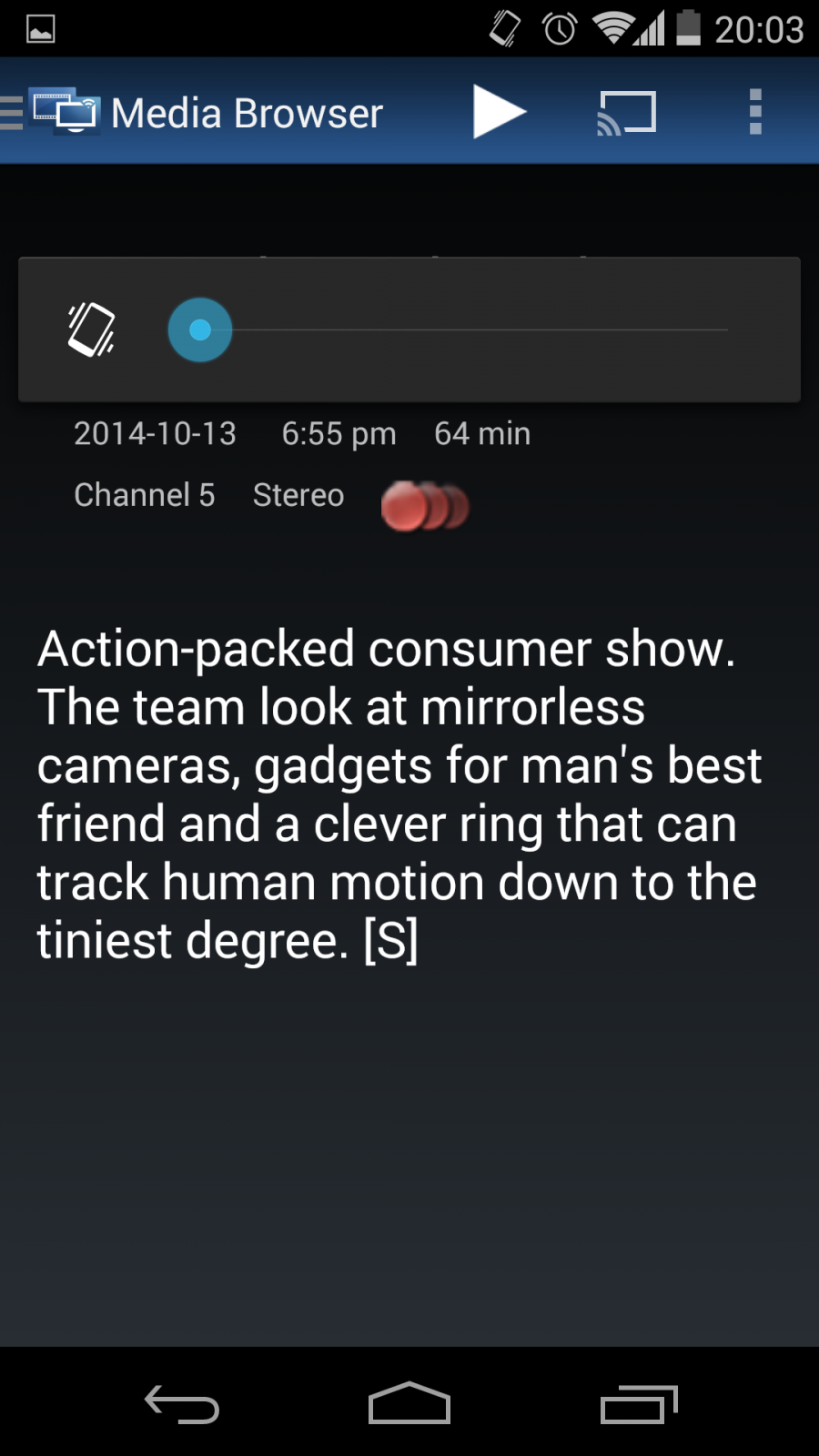

TheShanMan 41 Posted October 18, 2014 Posted October 18, 2014 (edited) I don't get subtitles whether I pick them before playing the movie or while the movie is playing. I also can't get the information display/player bar to go away during the movie. Once it shows, I can't figure out how to make it go away. This subtitle problem still happens for me. The app thinks subtitles are selected (checkbox on the subtitle choice) but I don't get subtitles. It's nice to see that the now-playing overlay goes away but it would also be nice if tapping the screen toggled the overlay rather than only showing it. If it's showing and I tap the screen, I would expect it to go away but it doesn't. Also, screens commonly look like this when they first load and I have to wait for around 10 seconds for the screen to show what it's supposed to. If my server is being slow to respond, it should at least give some sort of "loading" indicator because I thought the app was crashing or broken or something. Sorry for the size. I wish the forums would let me scale it down. edit: snip... Edited October 17, 2014 by Redshirt
Redshirt 1487 Posted October 18, 2014 Author Posted October 18, 2014 I've changed the overlay so that it will hide when tapped. As for subtitles. I can't recreate. They work fine for me. I need to know what your clicking and where. Client/Server logs would help too. 1

TheShanMan 41 Posted October 18, 2014 Posted October 18, 2014 I've changed the overlay so that it will hide when tapped. As for subtitles. I can't recreate. They work fine for me. I need to know what your clicking and where. Client/Server logs would help too. I'll try to get some logs for you. Thanks for making it hide when tapped. What about the problem where a page shows nothing but that little blue bar while it's trying to load the content?
