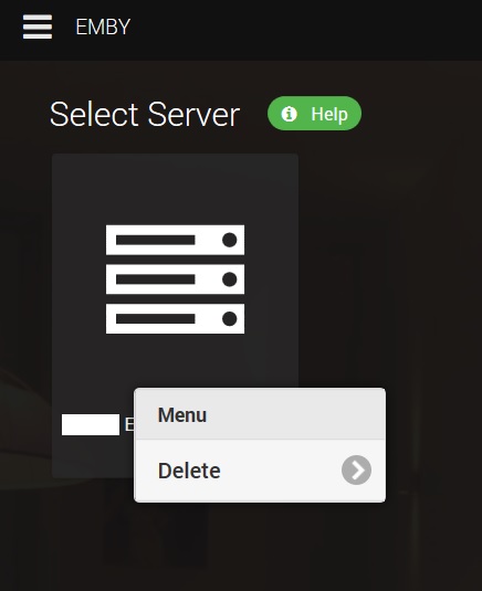

Malinthros 0 Posted July 15, 2015 Author Posted July 15, 2015 So something just changed for the better. I am able to connect now (on the mobile app) via the "Add Server" button after I manually enter my IP and port information. I believe that the server button that wouldn't connect used my old server before I did a fresh install of Emby? Could be wrong though. Is there anyway to delete this older server (so it doesn't show up) that doesn't allow me to connect? Thanks so much for all the help thus far.
Happy2Play 9799 Posted July 15, 2015 Posted July 15, 2015 In theory yes, I don't have any mobile apps but there should be a delete option. Currently there are a few of us that have issues deleting. http://emby.media/community/index.php?/topic/18799-how-to-remove-server-instance/ http://emby.media/community/index.php?/topic/23357-my-old-emby-account-has-full-access-to-my-server/ There is a link at the top of the forum "Web Client" you can use to connect and try to delete also.
