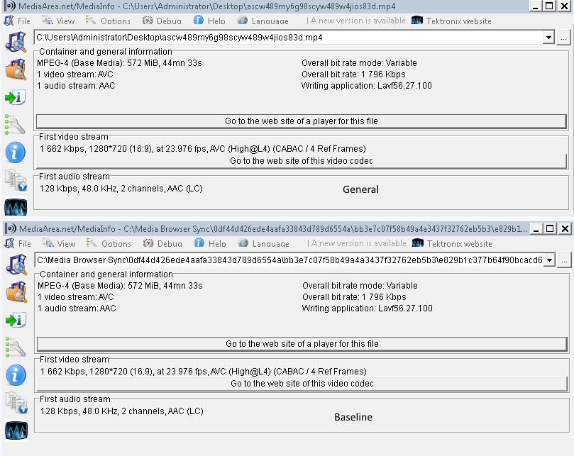

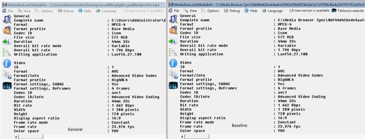

ThermoDust 12 Posted July 9, 2015 Posted July 9, 2015 I was playing around with some sync settings and tried baseline and general. Both playback on my Windows Phone without the need to transcode, which is wonderful! Then I started to look what settings were used and what the main difference was and couldn't find any. Can you please explain how those two settings are different?
Luke 42185 Posted July 9, 2015 Posted July 9, 2015 sometimes they will be the same depending on the input content, but the main difference is that baseline further restricts audio to exclude ac3 support because that's not going to be supported by web browsers
