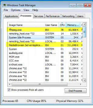

spon 26 Posted July 13, 2015 Author Posted July 13, 2015 Thanks so much Poptartica, I really appreciate your help. I went back and checked a bunch of my media and a large portion of it is MKV containers with AC3 audio, which seems to point to my issue being something completely different than what I thought it was. It sounds like I've probably been transcoding media this entire time without realizing it. So I guess my real problem is that media that used to transcode smoothly is now pretty much unwatchable. I used to get very smooth playback and now it pauses every few seconds. I checked the Task Manager on the machine running Emby Server and when transcoding my CPU is close to maxing out due mostly to ffmpeg. Is it normal for both Server and ffmpeg to be used during transcoding? I'm assuming so, but I'm a little out of my depth here. It if is normal, is there anything obvious that could be causing ffmpeg to be taking up so much CPU usage? Again, these are the same files that used to play smoothly. Thanks!!

spon 26 Posted July 13, 2015 Author Posted July 13, 2015 doesn't it throttle after a short period of time? Hi Luke, ffmpeg stays around 80-85% CPU usage for as long as I am playing the file via connect. good news is that the lastest beta server release does allow the video to play with much less frequent pauses, even at the high CPU utilization. my memory could be wrong, but I'm fairly certain in the past there were times when I experienced the issue of high CPU utilization and would just kill ffmpeg from the task manager all together. This would allow files to play smoothly and it seemed the Emby Server would be able to send the content without ffmpeg running at all. Again, this is from memory so if what I'm saying doesn't make sense, please ignore it. Thanks again for your help!!
