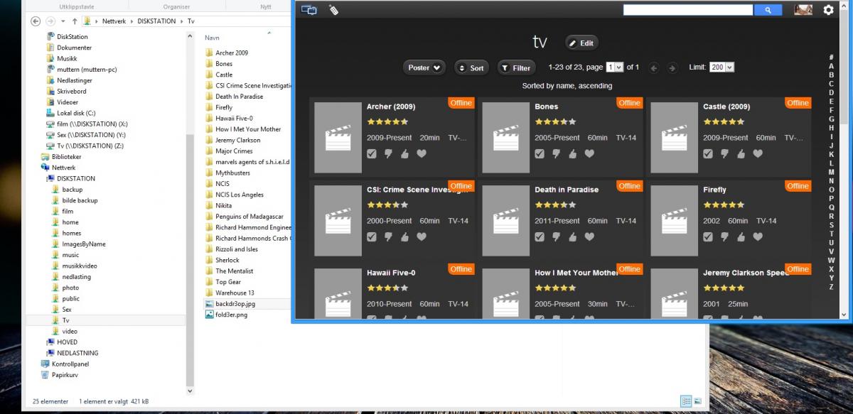

hnelson 1 Posted November 21, 2013 Posted November 21, 2013 Hi again this time my problem is that all my files are showing up as offline in mb3 server but i can see and access then in windows explorer (see picture) the files are stored on my synology diskstation and i can access them from everywhere except in mb3 hope anyone can help with this problem i shorten the server log and translated the errors the rest of the log had the same errors as shown server-63520643764.log

hnelson 1 Posted November 22, 2013 Author Posted November 22, 2013 We're unable to access your paths: Unable to retrieve file system info for \\DISKSTATION\music They may be online but as far as mb3 server is concerned they'er offline yes this was what i understand that meant, but why is it that mb3 can't find the files, when the rest of the system can find them ?
Redshirt 1487 Posted November 22, 2013 Posted November 22, 2013 Are you running the server as a service? If your NAs is expecting a user accounts credentials then the server running as a service won't be providing them.
hnelson 1 Posted November 22, 2013 Author Posted November 22, 2013 No i'm running the server as an app in the tray, and the strange thing is that it used to work just perfect then all of a sudden it started with this behavior some weeks ago.
