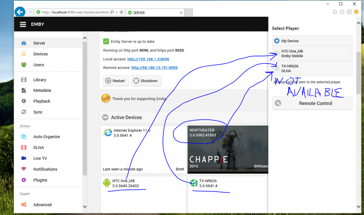

bret1958 27 Posted June 24, 2015 Author Posted June 24, 2015 Luke My theater is on version EMBY Theater 3.0.5362.41853 and i reinstalled the server on a new machine to sort out some issues. its on ver 3.0.5641.4 my problem I chose to work on first is My Theater PC can no longer be seen by any clients. The server can see it and it can now play from the server correctly but the server or clients can't see it as a device to play to. (I use this feature to help those who are remote control deficit)This is the biggest issue that I picked to work on first.So to date I reinstalled the stable release of server and it updated to this version 3.0.5641.4 by itself.The Theater is on EMBY Theater 3.0.5362.41853EMBY Classic can be seen and played to... but at the same time as this issue started, classic started to not pass on commands to Media Player so going back to Classic is off the shelf for now and is not the longer term solution. I am sorry but I cant take the theater pc off line at this time or I would just do an entire reinstall.Any suggestions I thought of letting EMBY theater update to Beta but thought I would wait to get your opinion Inclosed is a log and screen shot of what the server management page shows This is one of the issues that started after a automatic update to this.. I believe to be the current version. server-63570735625.txt

Luke 42289 Posted June 24, 2015 Posted June 24, 2015 Theater 3.0.5651 has been posted so i would start by updating to that and then we'll see if the problem persists 1
bret1958 27 Posted June 25, 2015 Author Posted June 25, 2015 Luke I update it everything works the latest version shows.. then I reboot and it is back at the old version and broken.. ? process repeated 3 times so it is still at 3.0.5362.41853 after reboot but when checking after install its at version 3.0.5651 oh man..
bret1958 27 Posted June 28, 2015 Author Posted June 28, 2015 I got the time today to re-install. Something just went haywire I guess. Put the server on a older machine and did a entire wipe of the Theater system after fussing with it for a few a few Hours and not getting any were. All seems to be back to normal, and am going to try to keep all the machines on the same build. I think the theater was a victim of media Emby for media center... I ignored it.. with some lousy plugins installed for to long, Running it along with EMBY Theater that was waiting to go prime time.. The networks is large for a home 9 pc and 10 or so devices, and a constant 5-10 guests.. SO she blew her cork so to say.. All the pieces picked up 3 new installs waiting for win10 with backup images. All seems to work fine. Keep pushing the updates .... tell EMBY Theater hits her prime time.. Thanks Guys for all the hard work I would not want your job...I am not a very good fireman..
