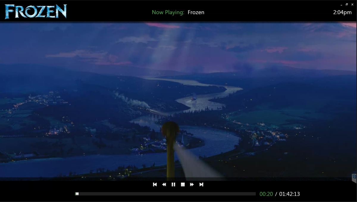

split 6 Posted June 27, 2015 Posted June 27, 2015 (edited) I have a similar issue, but i have some particular details i have not seen described here. Background ------------------- Until recently i have been running the server and theater software directly on my HTPC, and i have not accessed the content form anywhere else on my home network. Now i decided to expand the storage in my home server, and move all my content there, allowing me to (in future, if i get this figured out) to replace the HTPC hardware with a low power unit that will simply play back content from the server. Issue -------- I still have the Emby server installed on the HTPC. While i stay connected to the HTPC server installation, things work perfectly as they have for years. When i change the connection to connect to the server, some files simply wont play. Others start to play after 15+ seconds, but something is clearly wrong because it calculates the movie's duration as 5 seconds. Everything is on wired network. Though i can sit there and watch the content that way (the playback is fine once it starts), it is not marked as watched once complete, and i have to do it manually by setting the flag. While this works for some, other content will not start at all, even though the exact same file plays when i connect to the HTPC local server installation. After seeing this, i tried to connect to the HTPC server remotely and experienced the exact same behavior. Is this along the lines of what your issue? Has anyone encountered this? Edited June 27, 2015 by split

Poptartica 13 Posted June 28, 2015 Author Posted June 28, 2015 Hey, I just saw this. My tests were involving web interface only, and as mentioned there are still some users who can watch just fine and others on the identical browser/build who cannot. They get the same issue that split posted in their second screenshot. Due to this, right now a decent chunk of my users can't watch anything. I don't use Emby for local viewing so I'm still ok myself.

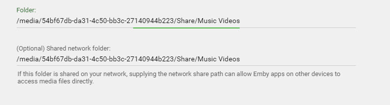

techworld 3 Posted January 29, 2017 Posted January 29, 2017 (edited) Hello, I'm in the same boat. I'm using UNC path, but no luck. I put it in 'Folder' and "Shared network folder' paths. i.e. /media/UUID/Share/Music Videos Edited January 29, 2017 by techworld

Happy2Play 9802 Posted January 31, 2017 Posted January 31, 2017 Hello, I'm in the same boat. I'm using UNC path, but no luck. I put it in 'Folder' and "Shared network folder' paths. i.e. /media/UUID/Share/Music Videos Are you saying you put this path in both locations? If so that is not a "Shared network folder" path.
techworld 3 Posted February 1, 2017 Posted February 1, 2017 I tried with & without the Network Shared path, it doesn't make a difference.
Happy2Play 9802 Posted February 1, 2017 Posted February 1, 2017 Using an image from another post, your network path should be something like this. Local path and network path are never the same.
techworld 3 Posted February 1, 2017 Posted February 1, 2017 (edited) I'm always use the local path. I'm give it a shot for the network path too. Update: It's working after I filled in the Network Path. What I don't understand is that the previous Emby last year, I only used the local path. You save the day! Thank you. Edited February 1, 2017 by techworld
