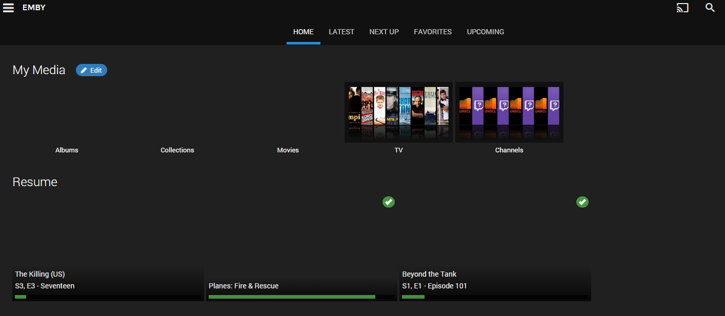

kolbasz 20 Posted June 20, 2015 Posted June 20, 2015 (edited) This could be all my fault, so I wanted to ask... I was running emby server using docker for a good while on a standalone ubuntu installation. This week, unraid 6 went gold, so I upgraded and thought to move my docker apps over to there, I installed the container and then proceeded to copy over all of my emby files from the ubuntu installation I had. I figured this will save time configuring and importing my media. I started the app and for the most part it is OK. It runs and serves out my data. I updated my kodi DBs and from that perspective things seem OK. However, when I go to the webgui, I am missing images for the media. I see the link for movies, but the image is not there. It shows me an episode title and again no image. As far as kodi goes, it seems to have the data as it looks normal, so I am trying to understand if what I did is a bad idea and if instead I should just start things over? Edited June 20, 2015 by kolbasz

Luke 42243 Posted June 25, 2015 Posted June 25, 2015 no - the fancy my media images on your screenshot up there
kolbasz 20 Posted June 26, 2015 Author Posted June 26, 2015 no - the fancy my media images on your screenshot up there ah, you mean the ones that arent there... I think you might have hit it on the nail. Feels to me like you just don't have enough resources. OK, so I upgraded my unraid system from 2GB ram to 4GB and now it seems things are happy. As of this morning, the webui was still available, something that was not the case in the past. Glad it was an easy fix. Ill plan to upgrade all hardware one of these days, but for now it is sufficient. What was broke is now fixed, so there is nothing else to fix... Thanks guys
