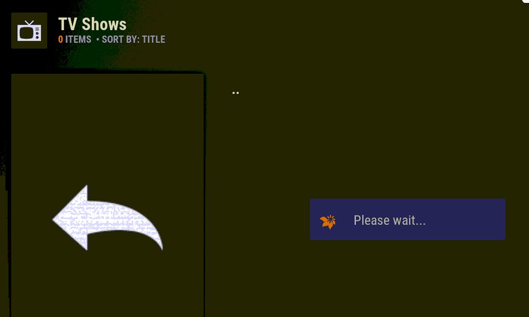

Scott84Z28 39 Posted June 12, 2015 Posted June 12, 2015 Hi. I'm trying out the Emby for Kodi add-on. I've using Helix 14.2 and the Beta Repo for the add on (1.0.06). Everything "appears" to install fine. It finds my Emby server and syncs everthing up. I can view and browser me Music, but if I go into Movies or TV Shows it shows 0, and a Please Wait thing is on the screen. It just sits there until I go back to the main menu. I'm testing with Artic Zephyr, but other skins are the same. If I go into settings, in the top left of the screen it does show that I have 1300+ movies and 300+ TV shows (and Music as well). Any thoughts? Which logs should I be looking at?

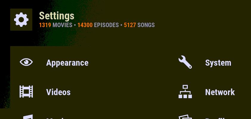

Scott84Z28 39 Posted June 15, 2015 Author Posted June 15, 2015 @Angelblue05, Any thoughts? If I go into TV Shows or Movies (either from the main shortcuts or through the add-on directly) I just see this: But in the settings I can clearly see that it did sync: I've attached the kodi.logKodi.log . Please let me know if you can help. Thanks in advance! kodi.log 1
Angelblue05 4132 Posted June 15, 2015 Posted June 15, 2015 (edited) It seems to get an error when retrieving userdata components? Maybe a corrupted Kodi? Can you try to reinstall to see if it helps? You can see all the errors even before Emby for kodi starts. Sent from my iPhone using Tapatalk Edited June 15, 2015 by Angelblue05 1
