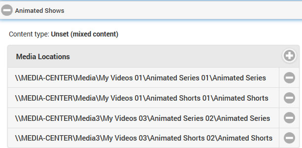

Mustang Dave 5 Posted June 5, 2015 Author Posted June 5, 2015 Checking before I do anything... I checked a fresh log (attacher) this morning for any "App: Error resolving path" errors and had none, but look at the attached, this is how I am currently setup... do I change or do I keep? @@ebr said "You need to change your media locations now to point to the drive references. Then the path substitution will take care of translating that to network paths for the apps that need it." but its working (no errors) ... Im not sure what should be done... F.Y.I.: Still have not added the music back in the Folder path yet, but its been added in the Path Substitution. @@Luke What did you make of this? Should have asked this last night about these errors: App: Error getting response from http://thetvdb.com/api/Updates.php?type=all&time=1433000296 App: Error getting response from http://emby.media/community/index.php?/blog/rss/1-media-browser-developers-blog Error getting response from http://www.mb3admin.com/admin/service/MB3ServerNotifications.jsn Do they run instantly when the computer wakes-up? If so then those errors could easily be caused by the lack of connection as the wireless internet connection is reconnected. As you know it takes 6-12 seconds for everything to reconnect... Anyway of putting a 30-45 second delay in? server-63569072033.txt
Luke 42289 Posted June 5, 2015 Posted June 5, 2015 media folders should be setup using d:\ instead of the network paths
