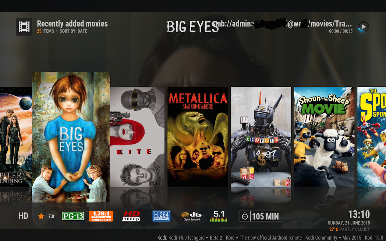

denethor 90 Posted June 21, 2015 Posted June 21, 2015 (edited) Yes, try a different skin Arctic Zephyr for example does not display that info Are you sure @im85288 This on OS X 10.10.4, Isengard Beta 2, Emby Add-on 1.0.13, Skin version 1.0.53 Edited June 21, 2015 by denethor
im85288 1493 Posted June 21, 2015 Author Posted June 21, 2015 Oops! Well I didn't notice that when I was browsing. There is a way to not show the now playing info when theme media is active..maybe I did that in 1080xf instead! I'll have a look 1
denethor 90 Posted June 21, 2015 Posted June 21, 2015 (edited) Oops! Well I didn't notice that when I was browsing. There is a way to not show the now playing info when theme media is active..maybe I did that in 1080xf instead! I'll have a look By the way this is not happing while browsing naturally. If you hit the <tab> to see full screen version of the theme while browsing and hit back to <tab> to go back library view than it shows the info. Edited June 21, 2015 by denethor 1
