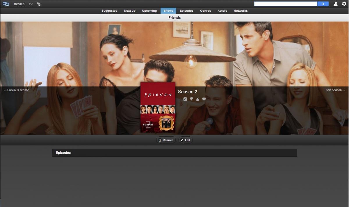

htdj03 0 Posted November 19, 2013 Posted November 19, 2013 I just update Media browser to version 3.0.5070.20258 and since then I can no longer browse any of my TV shows. I can see the seasons but when I select one of the season I don't see any of the episodes.Under Latest Unwatched Episodes I can play any of those videos. Movies play fine there isn't any issues with them just the TV Shows. I have attached the error from the servers log and also a screen shot of what I'm getting. 2013-11-18 16:17:12.3828, Warn, StringMapTypeDeserializer, Property 'id' does not exist on type 'MediaBrowser.WebDashboard.Api.GetDashboardResource' Any help is much appreciated. Thanks.
Luke 42171 Posted November 19, 2013 Posted November 19, 2013 what are the file names of some of those episodes?
htdj03 0 Posted November 19, 2013 Author Posted November 19, 2013 (edited) All of my file names are like this: 01 - Episode name.mp4 or 01 - Episode name.mkv Also from browsing my library I noticed that there are a few that work correctly. Still get the same error: 2013-11-18 16:42:35.7578, Warn, StringMapTypeDeserializer, Property 'id' does not exist on type 'MediaBrowser.WebDashboard.Api.GetDashboardResource' but I do see all the episodes for the season selected and the file format for these episodes are 01 - Episode Name.mkv This only works for like different shows the rest of my library I cannot browse the episodes. Edited November 18, 2013 by htdj03
ebr 16304 Posted November 19, 2013 Posted November 19, 2013 That naming convention is not one of the ones supported.
Luke 42171 Posted November 19, 2013 Posted November 19, 2013 go to the edit screen for the series, make sure season number is correct. then expand on the left hand side, look at the the episodes, make sure their season and episode numbers are correct.
htdj03 0 Posted November 19, 2013 Author Posted November 19, 2013 but it was working fine before I updated to version 3.0.5070.20258. I make the change on one that is not working and post my results.
Luke 42171 Posted November 19, 2013 Posted November 19, 2013 the current build is a little pickier. i'll see what i can do about that. however - if the we're not able to detect the numbers due to your use of an unsupported convention, you will potentially see quirks and/or loss of features.
htdj03 0 Posted November 19, 2013 Author Posted November 19, 2013 Thanks Luke that worked. the Episode Number was missing, I added it and now the episode appears. Thanks for the help.
Solution Luke 42171 Posted November 19, 2013 Solution Posted November 19, 2013 It's missing because we couldn't extract it from the filename because the convention is not on our supported list. we may at some point support that one, but i can't say when. 1
