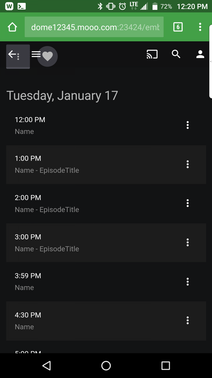

domenic 33 Posted January 17, 2017 Posted January 17, 2017 (edited) I still believe there is something a little off in Emby and the Guide data storage. Here is the test I ran. I configured one channel in VDR. Configured One Day for Guide in Emby. Setup the following test code: public IEnumerable<ProgramInfo> GetPrograms(Stream stream, IJsonSerializer json, string channelId, ILogger logger) { var root = json.DeserializeFromStream<RootObject>(stream); UtilsHelper.DebugInformation(logger,string.Format("[VDR] GetPrograms Response: {0}",json.SerializeToString(root))); logger.Info(string.Format("[VDR] Display Root Object: {0}", json.SerializeToString(root))); if (root != null && root.events != null) { return root.events.Select(epg => new ProgramInfo() { ChannelId = channelId, //Id = epg.id.ToString(), Id = "124941420000" //Overview = Regex.Replace(epg.description,@"\t|\n|\r", ""), //Overview = Regex.Replace(epg.description,@"[^A-Za-z0-9]", " "), Overview = "Overview", StartDate = ApiHelper.DateTimeFromUnixTimestampSeconds(epg.start_time).ToUniversalTime(), EndDate = ApiHelper.DateTimeFromUnixTimestampSeconds(epg.start_time).ToUniversalTime().AddSeconds(epg.duration), //Genres = new List<string>(), Genres = new List<string>(new string[] {"sports", "movie"}), //OriginalAirDate = parse infom from Description //OriginalAirDate = null, OriginalAirDate = DateTime.UtcNow, //Name = Regex.Replace(epg.title,@"[^A-Za-z0-9]"," "), Name = "Name", //OfficialRating = parse infom from Description //OfficialRating = null, OfficialRating = "G", //CommunityRating = null, // not provided CommunityRating = 10, //EpisodeTitle = epg.short_text, EpisodeTitle = "EpisodeTitle", Audio = ParseAudio(epg.description), IsHD = false, // not provided default to false IsRepeat = false, IsSeries = epg.description.Contains("series", StringComparison.OrdinalIgnoreCase), HasImage = (epg.images > 0), ImageUrl = (epg.images > 0) ? (_baseUrl + "/events/image/1/" + epg.id.ToString(_usCulture)) : null, IsNews = epg.description.Contains("news", StringComparison.OrdinalIgnoreCase), IsMovie = epg.description.Contains("movie", StringComparison.OrdinalIgnoreCase), IsKids = epg.description.Contains("kids", StringComparison.OrdinalIgnoreCase), IsSports = epg.description.Contains("sports", StringComparison.OrdinalIgnoreCase) || epg.description.Contains("Sports non-event", StringComparison.OrdinalIgnoreCase) || epg.description.Contains("Sports event", StringComparison.OrdinalIgnoreCase) || epg.description.Contains("Sports talk", StringComparison.OrdinalIgnoreCase) || epg.description.Contains("Sports news", StringComparison.OrdinalIgnoreCase) }); } return new List<ProgramInfo>(); } Note I am hard coding most of the variables - the exceptions are ChannelId, StartDate, and EndDate. The result should be a fully populated Guide of one channel with the same program. Which I see. When I select the channel I get the screen shot attached. It appears sometimes I get Name and sometimes I get Name - EpisodeTitle but all of the entries should be identical, with the hardcoded values Name - EpisodeTitle.Any idea based on the code why some of the data would be dropped? Edited January 17, 2017 by domenic 1
domenic 33 Posted January 17, 2017 Posted January 17, 2017 can you show a screenshot? Just attached it.... 1
Luke 42244 Posted January 17, 2017 Posted January 17, 2017 Try refreshing the guide data. also you just edited your post and now the code is all on one line and hard to read. 1
domenic 33 Posted January 17, 2017 Posted January 17, 2017 Try refreshing the guide data. also you just edited your post and now the code is all on one line and hard to read. That is with the updated Guide Data....(code replaced) 1
Luke 42244 Posted January 17, 2017 Posted January 17, 2017 it's due to the IsSeries property. When that is false, EpisodeTitle is not used. 1
