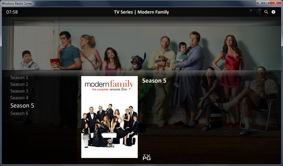

Scoobz 2 Posted May 28, 2015 Posted May 28, 2015 So for a better test I took my functioning Media Center PC with client 3.0.262 and upgraded it to 3.0.266. As soon as I did this the delays for TV series reappeared. This is all tested with the Subdued theme. I have attached a few screen shots to better illustrate, as you can see one seasons completes the episode list and one doesn't. If I back out and go back into the same series it will sometimes complete or at least complete the one you want to watch. I hope this assist further. I would also like to add thanks for all the assist.
ebr 16334 Posted May 28, 2015 Posted May 28, 2015 You guys have to do your testing with Chocolate. I can't control what Subdued is doing and I know it is doing some bad things.
